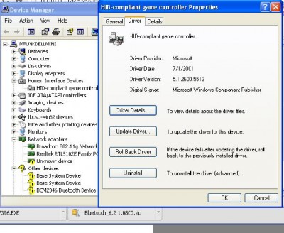

If you in widows go to Control Panel->Game Controllers->Properties for the PS3 controller do you manage to get some output then?

I get no output in windows Game Controller section.

Got it working!
Used Motionjoy but the real issue I found is you have to make sure that the C:\WINDOWS\system32 folder needs to be writable. By default its read only which is why you get errors in motionjoy and the drivers were not updating.
