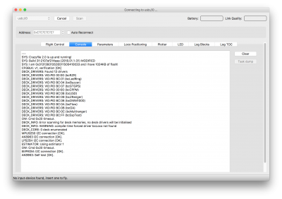

I think I did what you said and got the result in this picture. At the bottom it says self test ok but the led still blink 5 times fast.

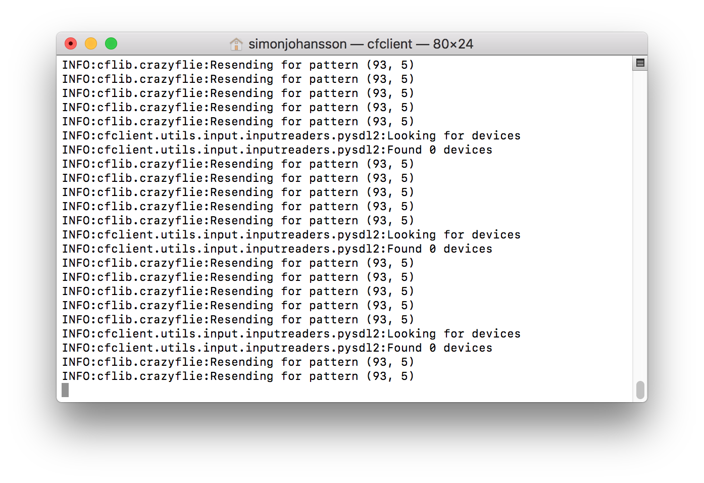

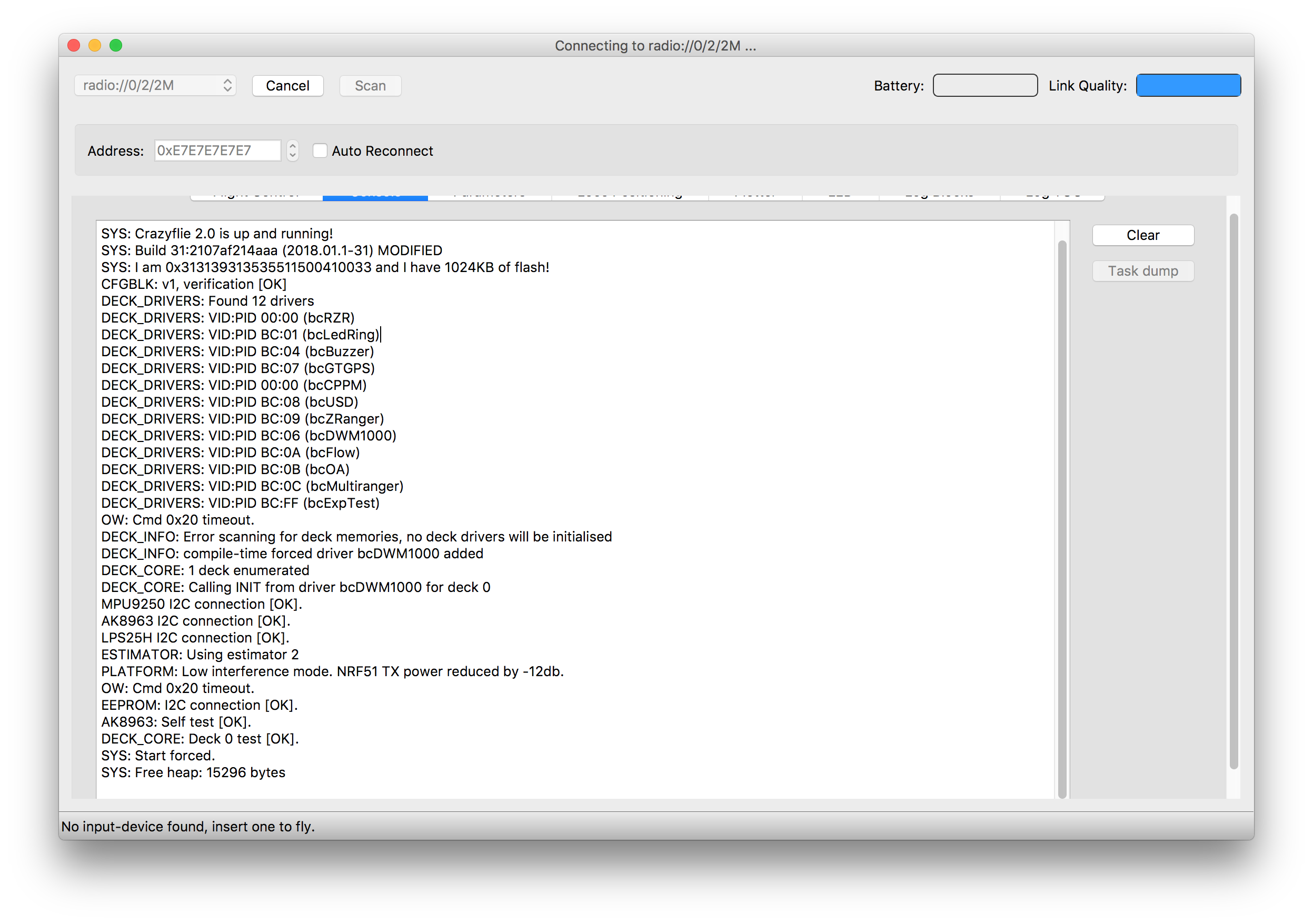

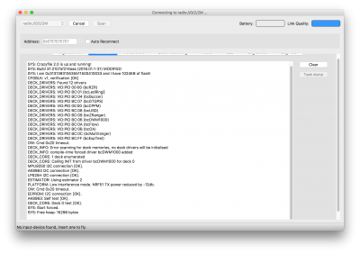

Okey, now i tested this with the new code and the param system.selftestPassed to 1 and this made the loco deck start blinking as if it would work. But it still would not connect to the radio in the cfclient. I show you the console and my terminal window.

It looks like the client is getting stuck in the startup of the communication and it is hard to debug without the problematic HW. You are getting the console info over the radio right?
Do you have the latest cfclient running?

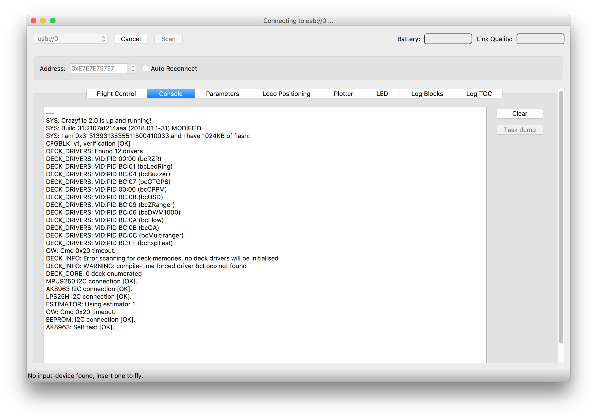

Okey.
I am using the USB to get the console info, since it will not connect by the radio.
Yes I got the latest cfclient.
