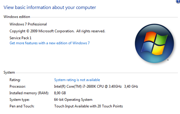

foosel - I wouldn't think it would matter...but what edition of Win7 x64 are you running? I was off earlier, actually running Ultimate on all of mine

Re: Cannot open Crazyradio [Errno 40] [Win7 x64]
Professional, with SP1:

Thanks foosel! So you installed the driver, installed the CFClient, and it just worked? No other tweaks or anything needed?
I tried messing around with my machines and getting this working natively again but still no go. Driver appears to install fine as usual but the client never sees the CR
