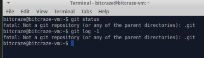

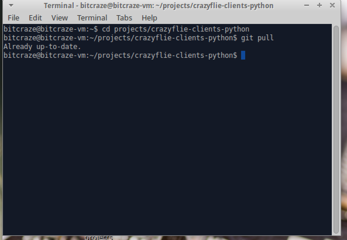

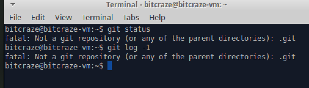

Okay, I updated my Crazyflie. I however didn't get some of those outputs that you mentioned. This is close to being resolved, I just really don't like seeing warnings even though you said it doesn't matter.

TheYoyoFreak wrote:Okay, I updated my Crazyflie. I however didn't get some of those outputs that you mentioned.
Those commands were all intended to be run in the same terminal window... You need to be inside the ~/projects/crazyflie-clients-python directory for those git commands to have any meaning. That folder is a git repository.

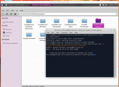

Okay so I got those correct outputs @Chad. I just ran the terminal from the "crazyflie-client-python" folder. I'm hoping that deleting the "Warning" line at the end of the __init__.py code was okay to do because that stopped the Warnings from popping up.
