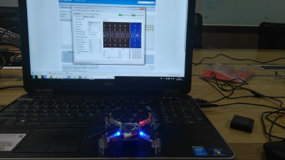

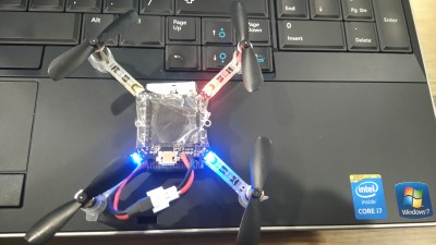

I'm able to connect to crazyflie via the cfclient. But the sensor values are different. In the attached images, the crazyflie is pointing towards the laptop screen. The flight data you see is when it's horizontal. Is there a way to reset the sensors ? If not, how to I fix it? Reflashing firmware?
Flie facing laptop screen

Flight data is tilted to right side

Do you still have this issue? If so then could you flash the attached firmware and past the console output from the Crazyflie?
