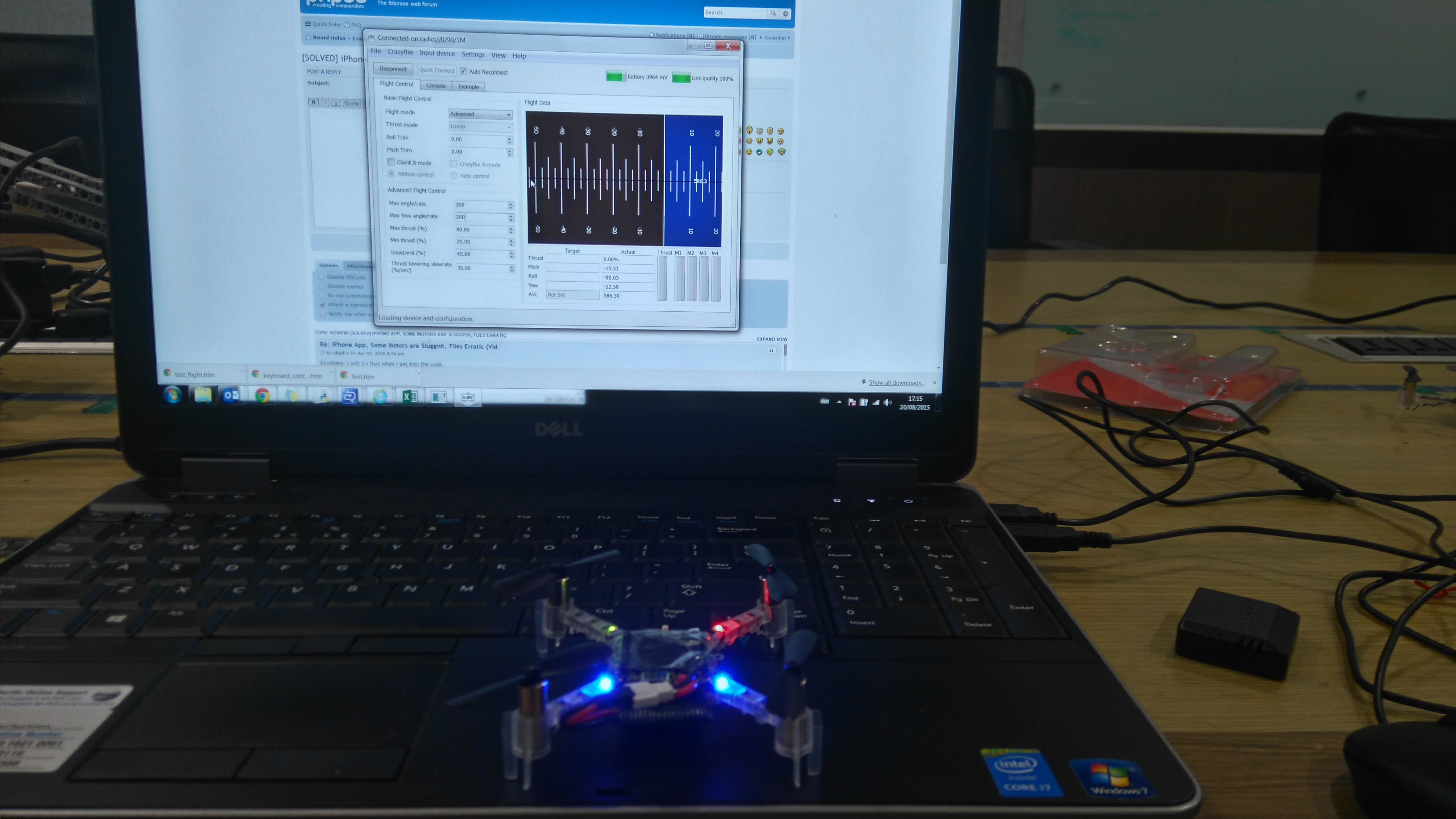

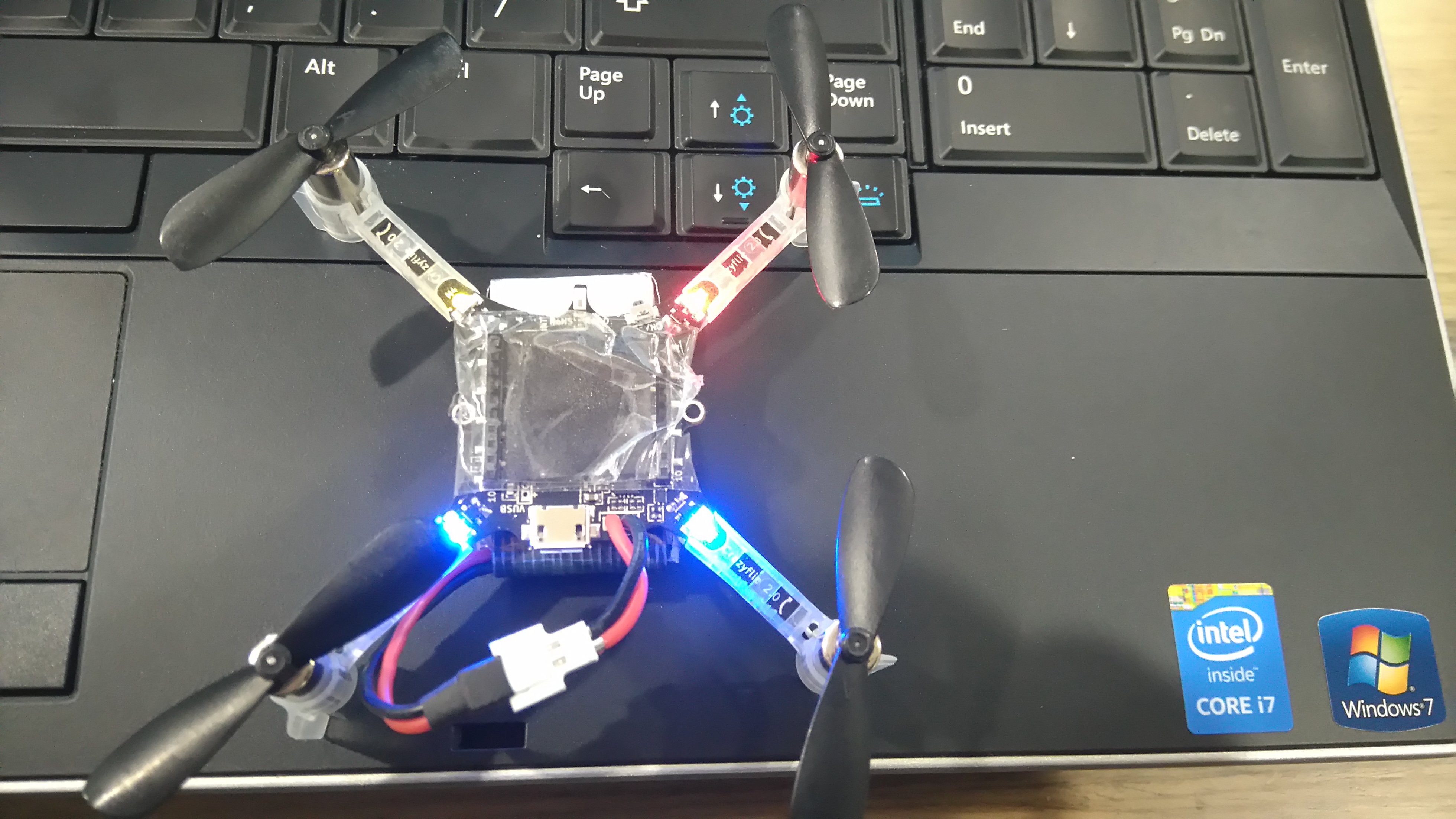

I'm able to connect to crazyflie via the cfclient. But the sensor values are different. In the attached images, the crazyflie is pointing towards the laptop screen. The flight data you see is when it's horizontal. Is there a way to reset the sensors ? If not, how to I fix it? Reflashing firmware?
crazy Flie sensor values are drunk! It's tilted 90 degrees
Re: crazy Flie sensor values are drunk! It's tilted 90 degrees
Do you still have this issue? If so then could you flash the attached firmware and past the console output from the Crazyflie?
