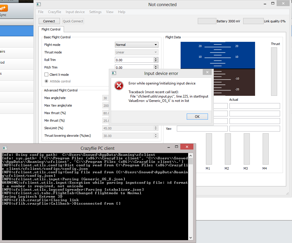

Hello all,
I'm trying to set up the PC client whilst I am waiting for my nano to show up and am getting the following error in the screenshot attached.
This occurred on reset after I set up my Logitech Extreme 3D Joystick in Input device configuration (roll, pitch, yaw, thrust all detected without issue). All these were detected fine with no issue and save appeared to work.
I saved out using the Generic_OS_X profile. Upon restart I now get the following error.
When clearing this error if I go back into Configure input device there are now no profile names listed and I cannot load/delete/save - only cancel. Joystick remains unconfigured.
I have tried reinstalling but the error remains.
I am using the binary distribution with the following debug info:

EDIT: Solution is to do the following!
1. Shutdown the CF PC Client program.
2. Remove %USERPROFILE%\AppData\Romaing\cfclient directory.
3. Restart CF PC Client.
This will allow you to enter a new configuration. Follow the instructions at http://wiki.bitcraze.se/projects:crazyf ... er_working and ensure you configure EVERY button and not just roll/pitch/yaw/thrust. This bug will be fixed in a later version of the client.
Thanks goes to Individual11 for additional error reporting and marcus for verifying the work-around.
Cfclient version: 2013.4.1
System: win32
System is Windows 8 (64 Bit).

I'm trying to reproduce this but I'm not having much luck. Any chance you could zip your C:\Users\Snowed\AppData\Roaming\cfclient folder (with sub-directories) and attach it here?
