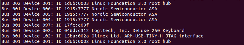

I purchased the Olimex ARM-USB-TINY-H programmer and have connected one end to the USB port of my computer using a USB B cable and the other end to the JTAG. I choose 'gapuino_v3' board. When I try to run the HelloWorld I am getting an error, which is attached txt file. When I run lsusb command I can see the 'Olimex Ltd. ARM-USB-TINY-H JTAG interface' in the output.
As per your previous message I should run below command first:
'export GAPY_OPENOCD_CABLE=interface/ftdi/olimex-arm-usb-tiny-h.cfg'
But as per the documentation this comes after setting up SDK. However, I ran this command but still I am getting the attached error.
Please help me resolve the error.

Re: Fot error when running PMSIS helloworld example
Hmm this is a bit weird that it wouldn't recognize your programmer. Your log mentioned:
but there is no description of it ? When you do lbusb, is that with the same vid and pid numbers?
We are not sure if this is perhaps an error in the latest version of the gap sdk, so perhaps it would be good to downgrade it and check again. We also have the docker container option that might be handier to switch between gap sdk versions.
Error: unable to open ftdi device with vid 0403, pid 6010, description '*', serial '*' at bus location '*'We are not sure if this is perhaps an error in the latest version of the gap sdk, so perhaps it would be good to downgrade it and check again. We also have the docker container option that might be handier to switch between gap sdk versions.
