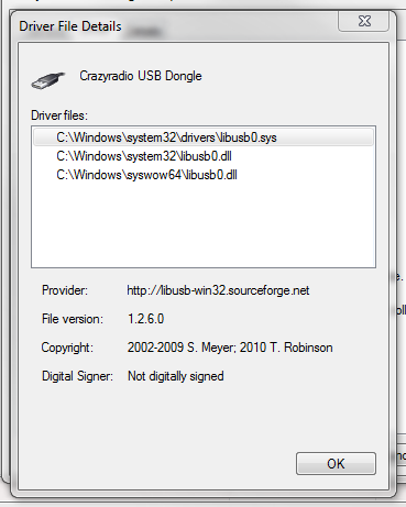

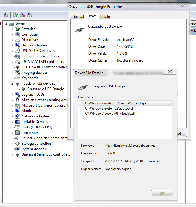

Just to be on the safe side, does you driver setup look like this?

My drivers look the same:
So at this point it must be something with my x64 installs. I haven't had issues with it in the past, but maybe it is the driver signing. I set the options to disable but they wont take effect until next boot...I will try that tomorrow
