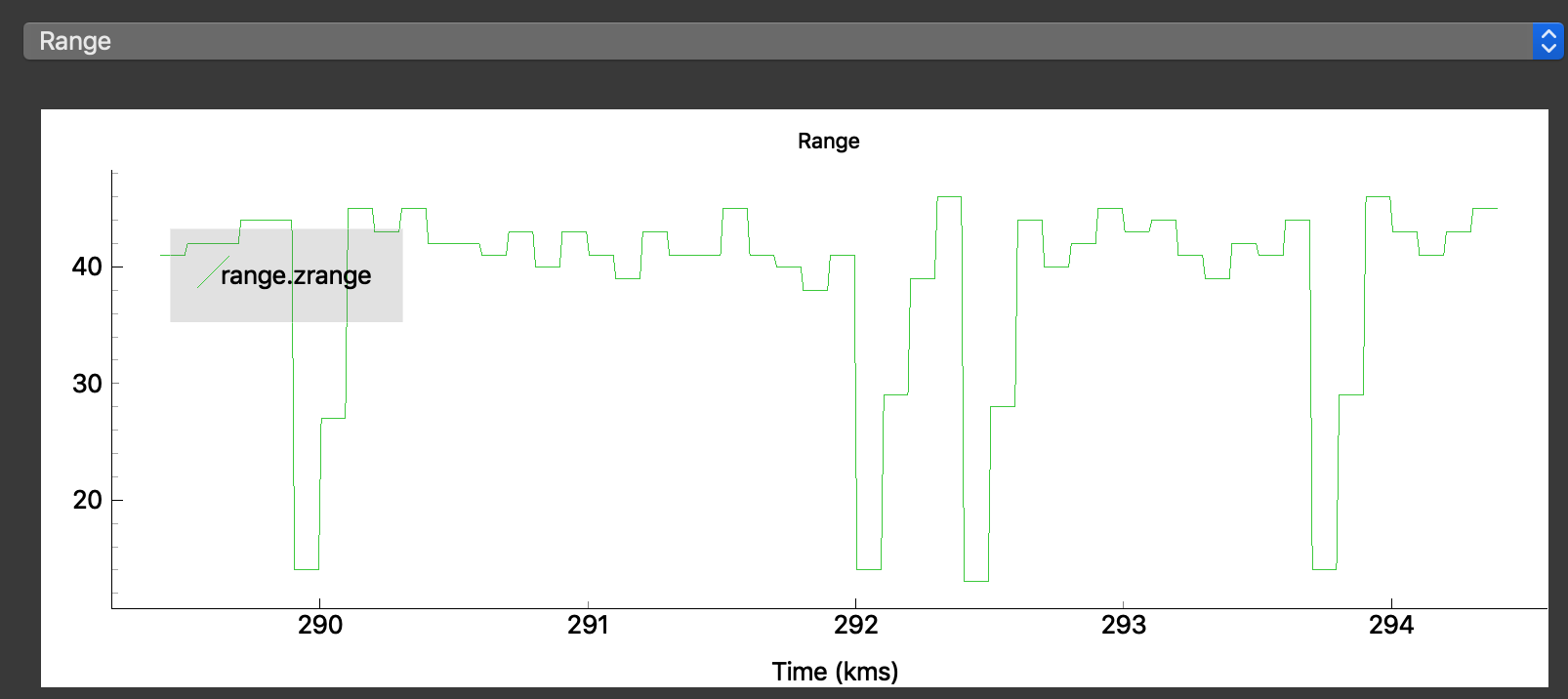

Post by cboustead » Tue Apr 09, 2019 9:16 am
I remembered that the issue is magnified when the CF2 is at higher altitudes.
I simply held the CF2 at a height of 30cm, with zero thrust, and this was my output.
Looks like the issue is with the zranger after all...

Posts: 1911
Re: Flow Deck V2 Not Stable
Post by tobias » Tue Apr 09, 2019 11:39 am
Yep, that looks like a problem with the zranger. We will arrange a replacement.
