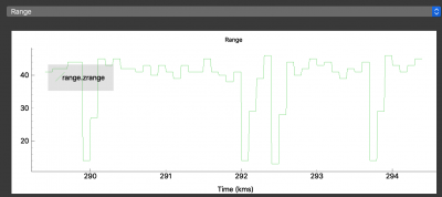

The zranger appears to be logging the correct values for flight.
When I try to fly the CF2 it flies up and down rapidly, hitting the floor on most occasions. This makes it hard to determine if there are any anomalies because the CF2 is changing height so often.
To overcome this, I held the CF2 and lifted it manually to plot the values. I did this with thrust on to ensure the battery was under load. You can see the results in the attached image. As you can see, there are no obvious anomalies.
I also monitored the plot with a lower sample rate so I could try and see any anomalies that might not show up in the longer plot, again, there were no obvious anomalies.
I was thinking it could be a power issue but when I fly the CF2 using an xbox controller without the hover mode there aren't any issues

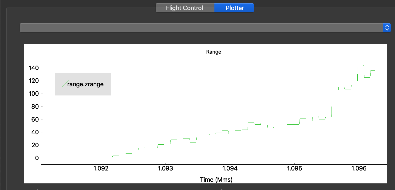

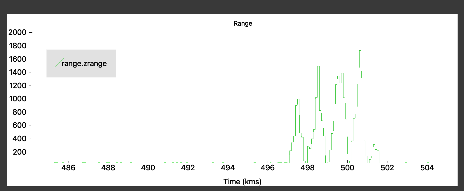

cf1 - Experiment where I manually changed the height by picking up the CF2 with thrust on.
cf2 - Experiment where I tried to fly the cf2 in hover mode. CF2 changes height.
cf3 - CF2 stationary on floor. There are some drops here but they are not drastic.

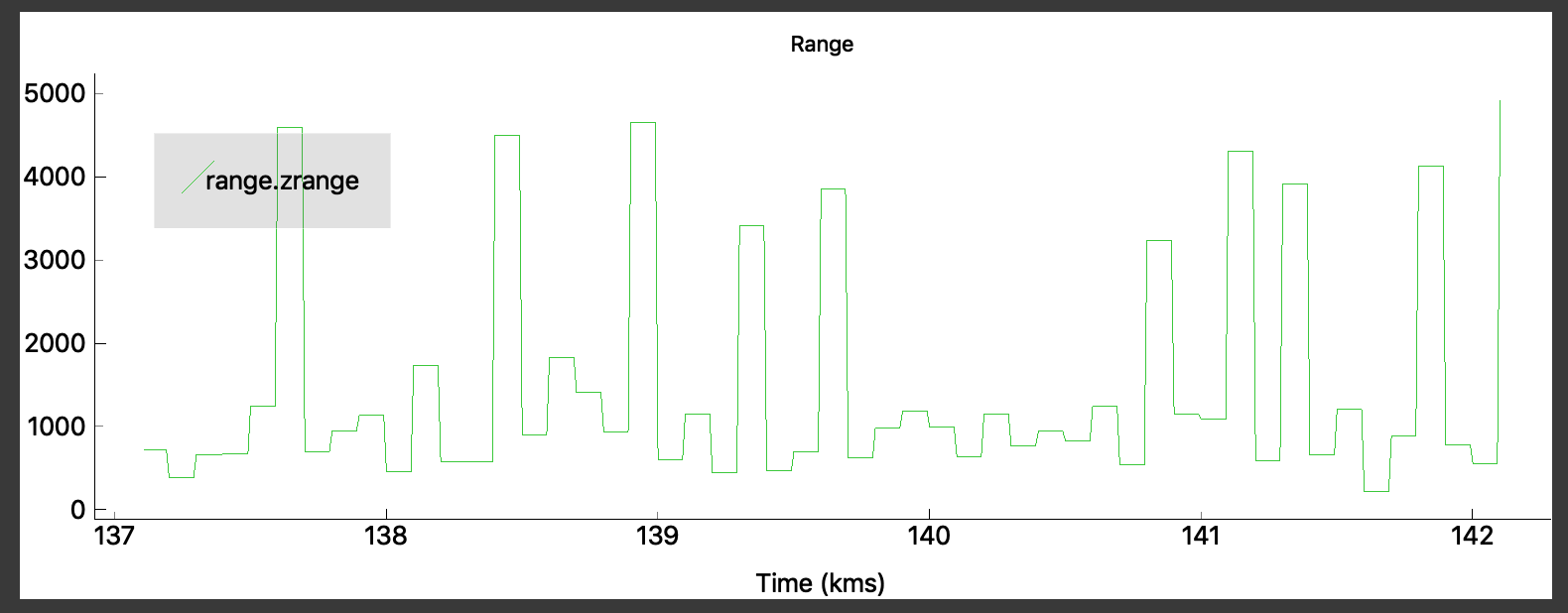

I remembered that the issue is magnified when the CF2 is at higher altitudes.
I simply held the CF2 at a height of 30cm, with zero thrust, and this was my output.
Looks like the issue is with the zranger after all...
Re: Flow Deck V2 Not Stable
Yep, that looks like a problem with the zranger. We will arrange a replacement.
