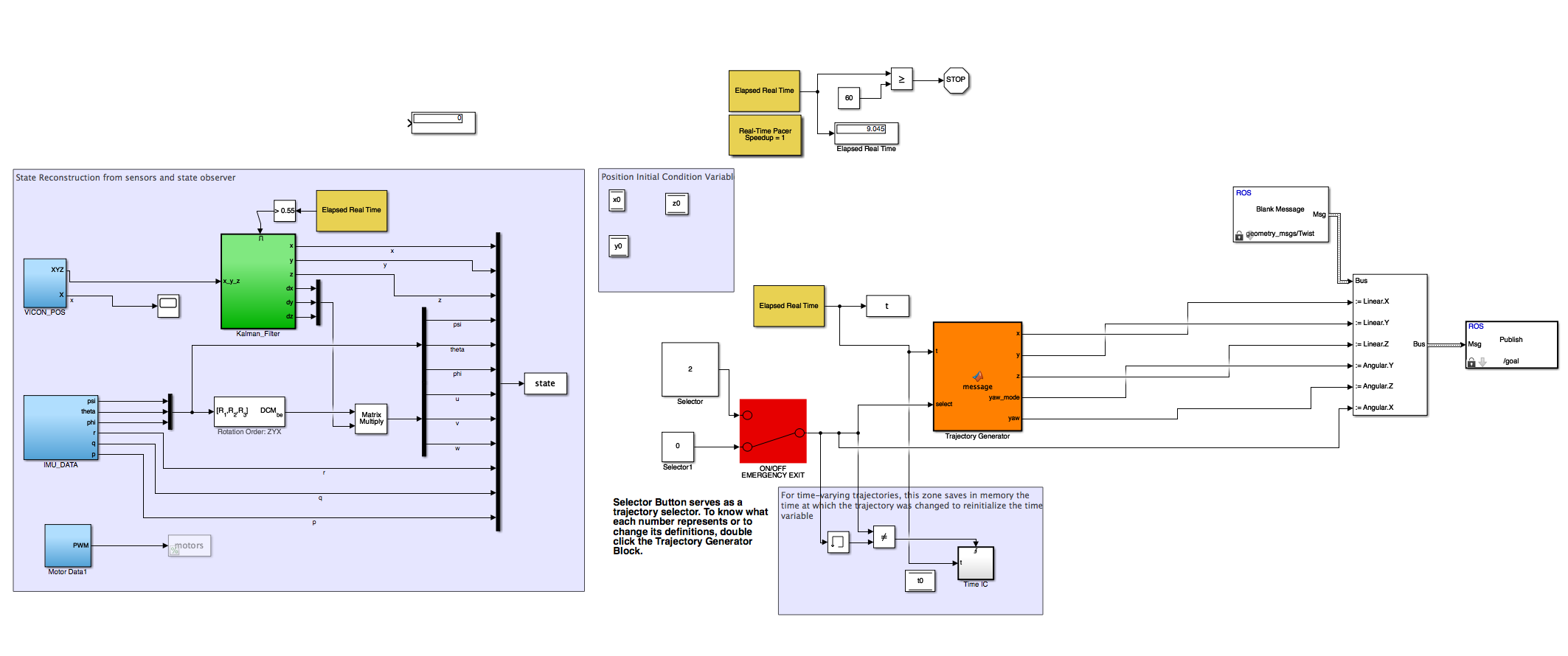

in the trajectory generation I send some position in x,y,z and yaw, the /goal topic can be published correctly and I can see the values that I send for example [x:0, y:0, z:0.5, yaw:0], but the drone do something else like if it has "no eyes". Can someone help me to find the problem?
I'm using Ubuntu 16.04 and LPS. This is my catkin workspace:

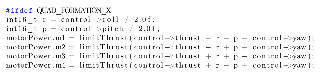

1) I run the latest firmware, so the 2018.01, In the firmware I changed two things because the body-fixed frame defined in the embedded system did not match the one adopted during the simulation phase: the first is the power_distribution_stock.c
and the second is the controller_pid.c

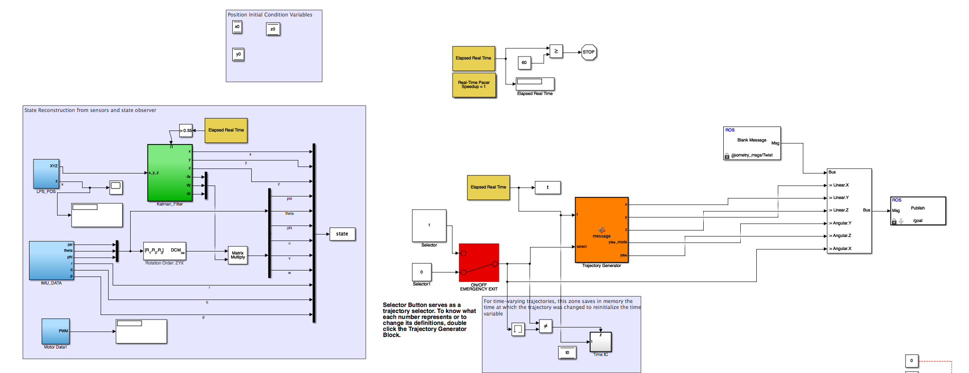

Now, everything compiles perfectly, the topic are published and when I run the MATLAB script the propellers of the crazyflie start to run, the problem is that it seems that the crazyflie has not a controller at all. For example here:
I just want that the crazyflie goes in (x:0,y:0,z:0.5) but it starts to fly in any direction like if there is no controller and there is no position sensor, I don't think it's a MATLAB problem because in the subscribers blocks I can see perfectly the values of all the sensors.
This is inside the LPS block:
and this inside the trajectory generation:

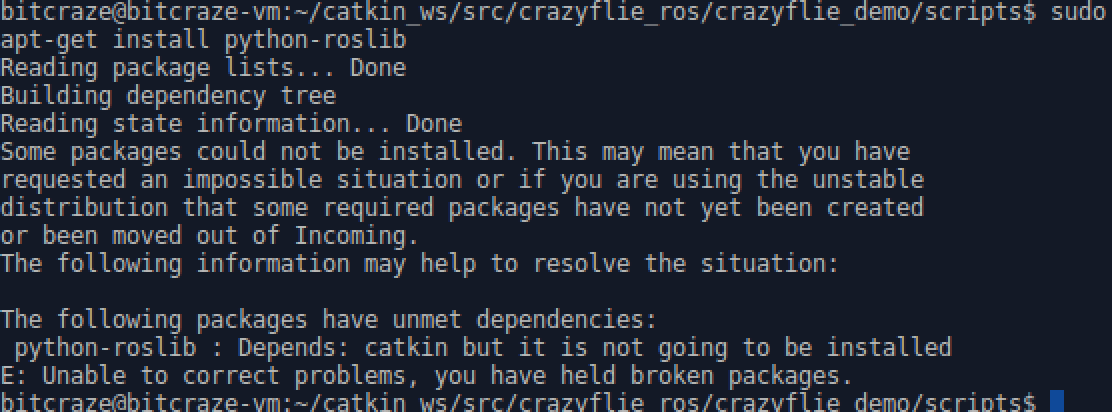

Thank you for this answer, I tried to run:
sudo python test_high_level.py
but this is the problem:
I tried:
What could be the problem?
whoenig
Posts: 327
Re: ROS package modifications, Crazyflie receives the wrong orientation
Post by whoenig » Sun Aug 12, 2018 12:58 am
Looks like ROS is not correctly installed. Did you install it yourself or are you using some kind of pre-configured system? Also, you shouldn't run normal code (such as this testing script) using sudo. If you get permission issues, you have to add the proper udev rules for the Crazyradio for your normal user account.
