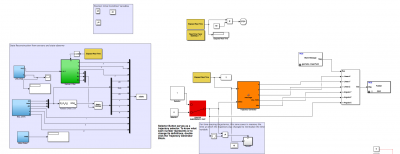

Like the guys, I modified the server script and the controller script in c++, in particular they created an user interactive topic named "/goal" created in MATLAB that lets the user choose between a number of predefined trajectories for the quadcopter to follow. Once the trajectory is selected, through a certain ID number that can be changed in real-time, the MATLAB node publishes the desired waypoint [xc, yc, zc, ψc]. An additional feature allows the user to choose whether to send position or velocity commands to the yaw angle of the drone.
I tried to implement the same things, and everything worked fine, the problem occurs when I tried to send some position to this topic from Matlab. The drone seems to not be able to see the position because he flies but with the orientation completely wrong. For example
in the trajectory generation I send some position in x,y,z and yaw, the /goal topic can be published correctly and I can see the values that I send for example [x:0, y:0, z:0.5, yaw:0], but the drone do something else like if it has "no eyes". Can someone help me to find the problem?

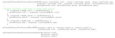

1) I run the latest firmware, so the 2018.01, In the firmware I changed two things because the body-fixed frame defined in the embedded system did not match the one adopted during the simulation phase: the first is the power_distribution_stock.c
and the second is the controller_pid.c

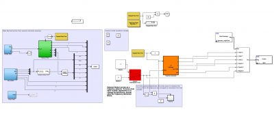

Now, everything compiles perfectly, the topic are published and when I run the MATLAB script the propellers of the crazyflie start to run, the problem is that it seems that the crazyflie has not a controller at all. For example here:
I just want that the crazyflie goes in (x:0,y:0,z:0.5) but it starts to fly in any direction like if there is no controller and there is no position sensor, I don't think it's a MATLAB problem because in the subscribers blocks I can see perfectly the values of all the sensors.

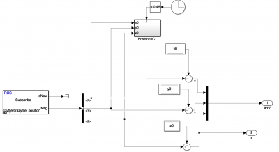

This is inside the LPS block:
and this inside the trajectory generation:

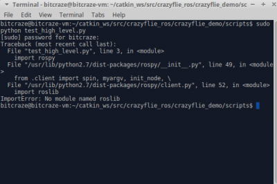

Thank you for this answer, I tried to run:
sudo python test_high_level.py
but this is the problem:

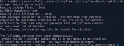

I tried:
What could be the problem?
whoenig
Posts: 395
Re: ROS package modifications, Crazyflie receives the wrong orientation
Post by whoenig »
Looks like ROS is not correctly installed. Did you install it yourself or are you using some kind of pre-configured system? Also, you shouldn't run normal code (such as this testing script) using sudo. If you get permission issues, you have to add the proper udev rules for the Crazyradio for your normal user account.
