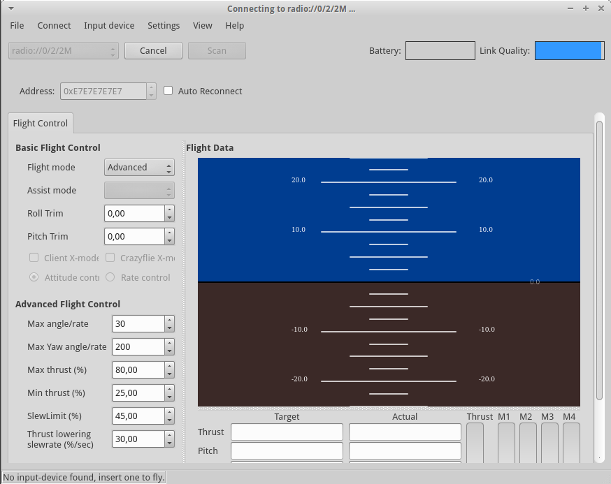

Okay, I've gotten through most of the "Getting Started with Crazyflie 2.0" instruction successfully this time. However, I run into problems when I try to actually click the "Connect" button within the Crazyflie Client on the VM. I have attached a screenshot of what the window looks like. As you can see, it says "Connecting to radio://0/2/2M ...", which would seem to indicate that it is in the process of connecting, however it never goes any further than this. Also, there appears to be an input for 'Link Quality', which is almost at full, but none of the other telemetry fields seem to be coming through. Is there something I can do to fix this? I have also attached a screenshot of the 'About Crazyflie Client' window to help diagnose any issues.

Both your attempt, with the client and with your script, are consistent. The connection process does not seem to go though.
Is the Crazyflie starting correctly? The M4 LED should blink GREEN multiple times at startup. One reason I see for the connection to not success is that the radio chip of the Crazyflie is starting but not the main CPU. In that case the behavior would be exactly as you described: the connection will never succeed but radio communication works.
What firmware are you running, have you updated your Crazyflie to the latest firmware when following the getting started instructions?
To answer the VM installation: python3-usb is already installed in the VM, it is needed to run the client and the examples. The VM uses an old version of Ubuntu where the package did not exist or had another name (I can't remember exactly), but the point is: except for idle3 everything should be already up and ready in the VM to control Crazyflie from a Python script. From your description everything is installed fine you just need to be able to connect your Crazyflie.

I am running the latest release of the Crazyflie firmware, which I downloaded from the Bitcraze GitHub as "crazyflie-2018.01". I then used the Crazyflie Client to update the firmware on the drone itself, as detailed in the "Update firmware in the Crazyflie" section of the Getting Started page (I attached a screenshot of the steps that I am referring to).
I think you are onto something with the LED's. According to the Getting Started page, plugging in a uUSB should initiate a self-test which will ideally result in the M4 LED blinking GREEN five times, as you said. As of right now, however, when I turn on the Crazyflie (either by using the power button or plugging in a uUSB), the only LED that turns on is M2 (the back right one), which is a solid BLUE color. The "Understanding LEDs" section (which I attached) does not provide any insight into this issue, as there is no listed condition which results in the back right LED being fully lit in blue. I tried redoing the firmware update process in case I messed it up the first time, but that did not fix the problem. While updating, however, the back two LEDs on the drone blinked blue and the front left LED flickered GREEN (it actually looked like yellow, but I could easily be wrong), which I believe is what should happen. But immediately upon finishing the update and exiting bootloader mode, the drone went straight back to only having one BLUE LED lit on the back right.
I also tried connecting the drone to my phone via the Crazyflie app, which is also the first thing I did after assembling it a few weeks ago. When I tried it then, it worked, and I was able to make the drone fly. However, when I tried the same thing a few minutes ago, I could not. The app said that it established a connection with the drone, but moving the joysticks to send motion commands did not produce any response. So, it is clear that something has happened to the drone between assembly and now which has hindered its ability to operate, but I do not know what that would have been, as I have only been following the instructions given.
Any insights?
Any insights?

It looks like the flashing procedure is not working, you get a corrupted firmware in the drone. There is two things that can help
- Installing the winUSB driver instead of libUSB for the Crazyradio using Zadig and updating the Crazyflie again from within the VM.
- Installing the client on Windows, reverting to libUSB, and updating from the native client.
I have observed that sometimes updating from the VM failed, though it is normally intermittent.
