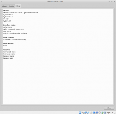

I appreciate that you are trying to help, but I don't think I'm properly expressing what my struggle is. You are saying that I can simply 'execute the script' but it has not been that easy. Let me tell you where I am at right now.
I am on the desktop of the Virtual Machine. I have clicked the icon to update all projects. I have the Crazyradio plugged into my USB port. I have the CrazyFlie turned on. I can open a code in the Python IDE (IDLE3). I can run the code. However, after running the code, the output shown on the shell is quite long and the gist of it is that the program cannot find the Crazyradio dongle.
Is this an issue with the code? I know the line with "URI = 'radio://0/80/250K'" must be changed to reflect the identity of my personal Crazyradio. Where do I go to find my personal URI? I have tried opening up the CrazyFlie Client, but it shows no indication that I have a Crazyradio connected, and therefore no indication of how I can connect to the Crazyflie.
I hate to be a pest, but could you please just give me a step-by-step instruction of how to go from having downloaded the virtual machine and plugged in the Crazyradio, to being able to run a Python code that will be sent to the drone? I would very much appreciate your help. Thank you.

Well I can only help if I know your state, thanks for updating your current state. Since you have idle3 running in the VM I would say that you have managed quite well so far
If would be useful to know the exact error you are getting when running the script. If it is complaining about the Crazyradio being not detected it seems that you have not setup the Crazyradio to be passed in the virtual machine usign VirtualBox.
Do you have the Crazyflie flying manually from the virtual machine using the crazyflie client?

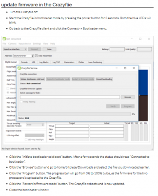

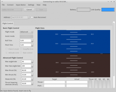

Okay, I've gotten through most of the "Getting Started with Crazyflie 2.0" instruction successfully this time. However, I run into problems when I try to actually click the "Connect" button within the Crazyflie Client on the VM. I have attached a screenshot of what the window looks like. As you can see, it says "Connecting to radio://0/2/2M ...", which would seem to indicate that it is in the process of connecting, however it never goes any further than this. Also, there appears to be an input for 'Link Quality', which is almost at full, but none of the other telemetry fields seem to be coming through. Is there something I can do to fix this? I have also attached a screenshot of the 'About Crazyflie Client' window to help diagnose any issues.
For the "Getting Started with the STEM Drone Bundle" instruction, I tried to run the line of code "sudo apt-get install python3 python3-pip python3-usb idle3" within the terminal on the VM. The output told me that it was "Unable to locate package python3-usb". So, I tried typing the same command except without the "python3-usb" part, and that seemed to work. Is this "python3-usb" an important package? If so, how can I install it if this did not work?

Both your attempt, with the client and with your script, are consistent. The connection process does not seem to go though.

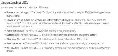

Is the Crazyflie starting correctly? The M4 LED should blink GREEN multiple times at startup. One reason I see for the connection to not success is that the radio chip of the Crazyflie is starting but not the main CPU. In that case the behavior would be exactly as you described: the connection will never succeed but radio communication works.

I am running the latest release of the Crazyflie firmware, which I downloaded from the Bitcraze GitHub as "crazyflie-2018.01". I then used the Crazyflie Client to update the firmware on the drone itself, as detailed in the "Update firmware in the Crazyflie" section of the Getting Started page (I attached a screenshot of the steps that I am referring to).
I think you are onto something with the LED's. According to the Getting Started page, plugging in a uUSB should initiate a self-test which will ideally result in the M4 LED blinking GREEN five times, as you said. As of right now, however, when I turn on the Crazyflie (either by using the power button or plugging in a uUSB), the only LED that turns on is M2 (the back right one), which is a solid BLUE color. The "Understanding LEDs" section (which I attached) does not provide any insight into this issue, as there is no listed condition which results in the back right LED being fully lit in blue. I tried redoing the firmware update process in case I messed it up the first time, but that did not fix the problem. While updating, however, the back two LEDs on the drone blinked blue and the front left LED flickered GREEN (it actually looked like yellow, but I could easily be wrong), which I believe is what should happen. But immediately upon finishing the update and exiting bootloader mode, the drone went straight back to only having one BLUE LED lit on the back right.

It looks like the flashing procedure is not working, you get a corrupted firmware in the drone. There is two things that can help
- Installing the winUSB driver instead of libUSB for the Crazyradio using Zadig and updating the Crazyflie again from within the VM.
- Installing the client on Windows, reverting to libUSB, and updating from the native client.
I have observed that sometimes updating from the VM failed, though it is normally intermittent.
