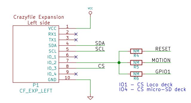

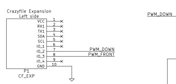

Operationally, I have a question - the Flow deck uses the LeftExpansion7 (IO_2) pin and so does the LED Deck for the serial data for the WS2812B LEDs (labelled on the schematic as PWM_DOWN). How does that pin overloading work?
Images for reference...
Flow Deck:
LED Ring Deck:
Re: Flow and LED deck combined?
In that hack I think it the front led signal line was just cut.

Huh... then how does the firmware handle it?
When the drivers for the flow deck and ring deck are enabled, IO_2 is still overloaded in the firmware right?
That is, the ring deck will output a PWM on the line, and the flow deck driver will implement the RESET/MOTION logic?

Nevermind.... I just saw that IO_2 is NOT used on the flow deck :P
Even though the schematic shows R4, R5 and R6 connected to IO_2, they are not populated on the boards.
Maybe update the schematic to reflect this?
Posts: 2538
Post by arnaud »
The resistors to IO_2 are marked "NM" which means Not Mounted. I guess we can add some textual explanation on future schematic to mark clearly that these are intended to be not populated out of the box.
