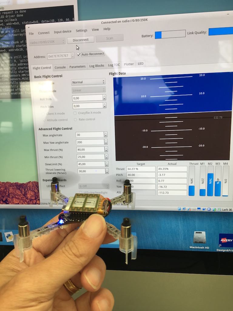

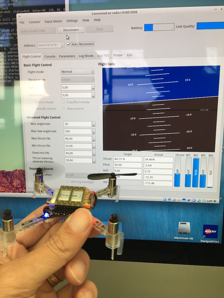

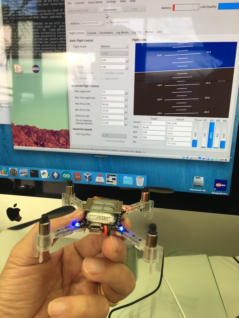

This is what it looks like when I connect to CF. As you can see, the motors turn off while thrusting.

This can be perfectly normal behavior as the regulation tries to move the CF2 into commanded position.This is what it looks like when I connect to CF. As you can see, the motors turn off while thrusting.
Have you double checked your setup, right propellers on right motor and propeller facing the right way? Also check the propellers are spinning in the right direction.
