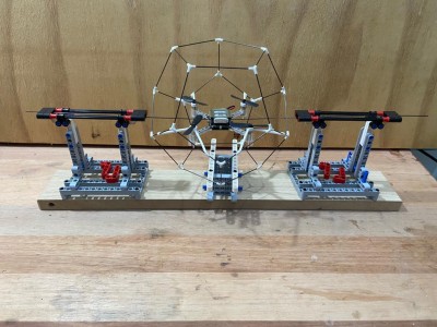

I'm trying to send the pitch angle setpoint to crazyflie 2 using python lib.
It may seem like a naive question, but does the command send_setpoint (roll, pitch, yawrate, thrust) send the desired setpoint of the pitch angle?
I modified example/ramp.py to send with send_setpoint(0, 10, 0, 20000) for two seconds and then change send_setpoint (0, 0, 0, 20000) for two more seconds.
Using the structure below to limit the crazyflie's movements, I expected it move to an angle of 10 degrees for two seconds and then return to the 0 degree (horizontal) position.
But crazyflie spinning constantly for two seconds and then stopping and staying in that position for another two seconds.
Looking like I'm sending rate pitch instead of pitch.
I tested it several times, tried set 'flightmode.stabModePitch' parameter to 1 and building and upload again the firmware, but this effect persists.
So how do I send a pitch angle reference?

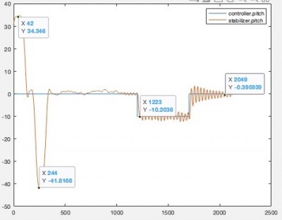

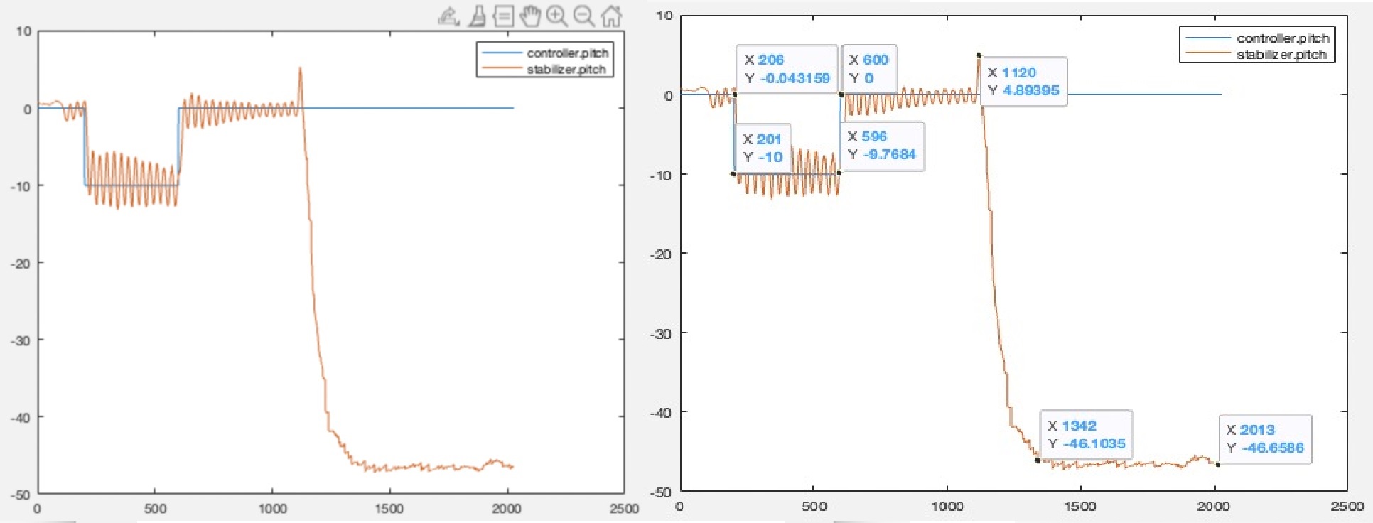

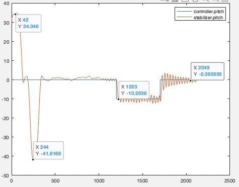

Then I changed lines 98 and 99, increasing the pitch on line 99 from 5 to 10 and reducing the period from 5 seconds to 2.5s. If I'm really sending rate pitch, expect the drone to stay at the same pitch angle, but faster.
This is the exact code:

Well, we did a few more investigations.
First, we found one more strange thing. When we are not sending pitch commands the variable stabilizer.pitch seems to work as it should, but as soon as the engines turn on stabilizer.pitch it looks more like rate pitch.
This is the exact code we used.

During the initial 9s we manually moved the cf to an angle of around 45 and -45 degrees to prove that stabilizer.pitch looks reasonable. Then we send pitch = 10 and thrust=20000 with the send_setpoint command for 4 seconds and then pitch = 0 for 5 seconds, again showing incorrect behavior (see video).
https://youtu.be/hmB6R-fNXB0
But then if you analyze the response obtained with logging, table below, it is noticed that stabilizer.pitch is providing erroneous feedback to the PID controller when we send pitch! = 0 and thrust!=0.
And in another test to show that there is a problem with the variable stabilizer.pitch, we change the order, i. e, first we send the command pitch = 10 and thrust = 20000 for 4 seconds and then we change pitch to 0 for 5 seconds and we clearly see that the pitch (angle) is nowhere near 10. Then we change pitch and thrust to zero and keep the drone in position manually as can be seen in the video below.
https://youtu.be/Sm1gB5TJExM
This the code used in second test.

As we can see in the table below, stabilizer.pitch is behaving erroneously since the cf is not at the 10 degree angle. By sending pitch = 0 and thrust = 0 and keeping the drone in the final position manually, we can see that stabilizer.pitch is going to the correct value.
Posts: 2538
Re: Send pitch angle
Post by arnaud »
I am not sure what is happening on your rig, I cannot reproduce your problems as for me the attitude control looks good (a bit "nervous" but my rotation axis does not pass through the center of mass and has some friction so it might explain some oscillations).
I tried to build a similar experiment and one problem I have almost directly is that there is a buid-up happening which likely comes from the roll and yaw control loop trying to correct a static platform. The effect of the roll and yaw loop can be disabled by setting to 0 the parameters "pid_rate.roll_k*" and "pid_rate.yaw_k*".
I tested both your scripts and they behave quite well for me, this is the second one: https://drive.google.com/file/d/1f2acdm ... sp=sharing. The PID build-up can be seen with one of the motor stopping, this is the yaw PID trying to compensate.
To get rid of the buildup, I made a new script that disables roll/yaw and goes to [0, 10, -10, 0] degree in steps of 4 seconds: https://drive.google.com/file/d/1ez_Nox ... sp=sharing. This is the script:
