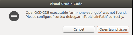

and when I tried to debug, it returns this issue ''OpenOCD GDB executable "arm-none-eabi-gdb" was not found.
Please configure "cortex-debug.armToolchainPath" correctly''

I did it, I can't debug. It still this issue ''OpenOCD GDB executable "arm-none-eabi-gdb" was not found. Please configure "cortex-debug.armToolchainPath" correctly''

Always the same problem. ""OpenOCD GDB executable "arm-none-eabi-gdb" was not found. Please configure "cortex-debug.armToolchainPath" correctly.""""

No, I said that I have the issue in the screenshot that I put previously.

It seems that you are just missing gdb. On Ubuntu there is a package called "gdb-multiarch" that seems to replace all platform specific gdb.
On my machine I could get vs-code cortex debug to work by adding a link to gdb-multiarch:
This allows vs-code to find gdb. You should just have openocd installed and then debugging should work using the st-link.
