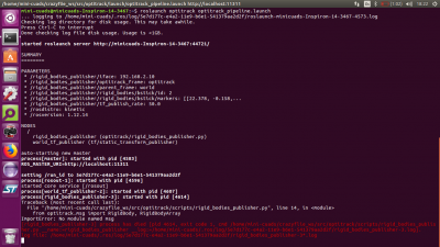

I work with ubuntu 16.04 the version of ROS that I use is kinetic, I have followed the steps shown in https://github.com/briankim13/crazyflie_bk as is the boys in the video, but at the time of typing "roslaunch optitrack optitrack_pipeline.launch" (minute 13:07 of the video) in the terminal to get the position and orientation of a rigid body in ROS it shows me the following error(image)
Error
Error
The error that shows me talks about a module called "optitrack.msg" which imports 2 files called: "RigidBody" and "RigidBodyArray"
these 2 files are in a code called "rigid_bodies_publisher.py"
which as main lines has the following

To solve the error I tried the following:
1.- Put the files "RigidBody.msg" and "RigidBodyArray.msg" in the same folder where the file that generates the error is located which is
2.- Place the files "RigidBody.msg" and "RigidBodyArray.msg" in another module
3.- The module was renamed
but none turns out, if someone could help me with this I would greatly appreciate it,
