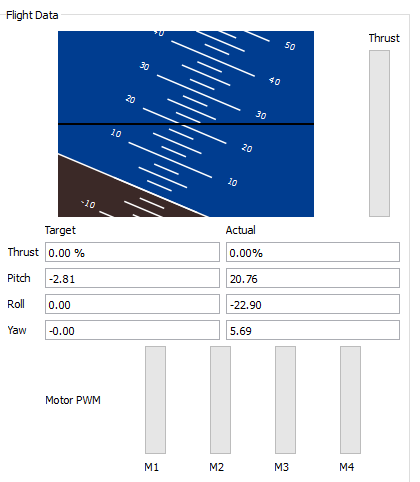

In any case, I can't fly it anymore. One of the sensors seems to be acting out since I can't balance it anymore and when I place it on a straight surface, the telemmetry screen shows it as slightly sideways (see screenshot). Consequently, it is off-balance when I try to have it take off and it just ends up turning around. Any idea on how to resolve it or did I accidentally damage it when flying around? If so, any replacement options?

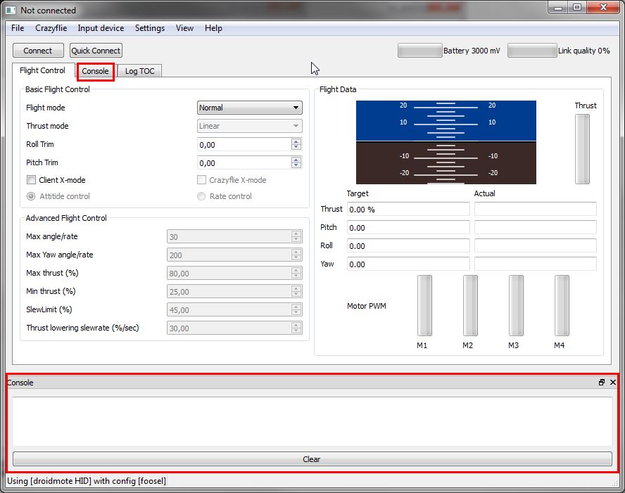

Do you get any error messages in the console tab?

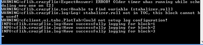

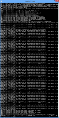

Quite a few. The most relevant one seems to be "Unable to find variable [stabalizer.roll].
Updated with screenshot of the console log.

Sorry, I meant the actual CF console output, either in the corresponding tab or as a toolbox:

This looks fine... And the horizon stays this slanted even after multiple "reboots" of the CF (while keeping it completely straight)?
