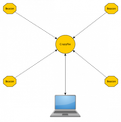

thank you for your nice answer. That is also interesting, although I think you understood me wrong or I explained it confusing.
We want the Crazyflie to receive BLE signals of the iBeacons. It should calculate its position by the principle of trilateration from the RSSI of the beacons OR we provide the raw data through the logging framework and let it be calculated client side?! Both could work I guess.
The Crazyflie should of course be controlled from a computer/client while being connected with the Crazyradio. So the Crazyradio should not do additional work, we don't want to touch that.
We just need to be sure that the Crazyflie can be controlled and receive iBeacons signals parallely and how we can access the iBeacons signals on the Crazyflie/firmware-side. I hope it's more clear now and also created a small diagram to the attachment.
Thanks for your time
