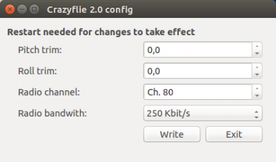

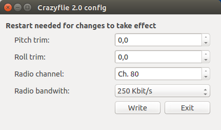

In the new cfclient there is a config screen where you can set trim values permanently. This will compensate for e.g. a tilted MPU9250 chip. You get to the menu by first connecting to the CF2 then under Crazyflie->Configure 2.0 you'll find the paramters. We are still lacking documentation for this but we are working on it.
