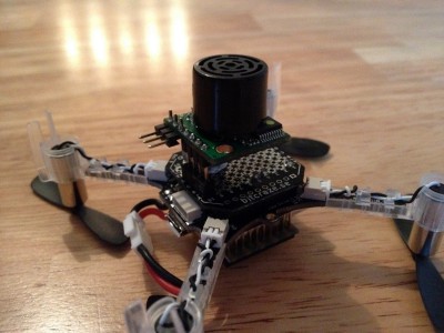

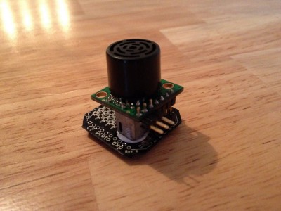

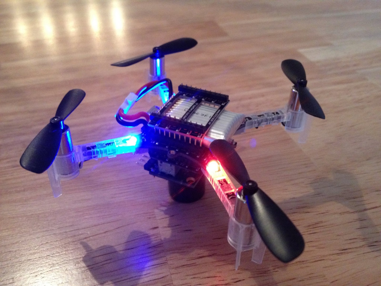

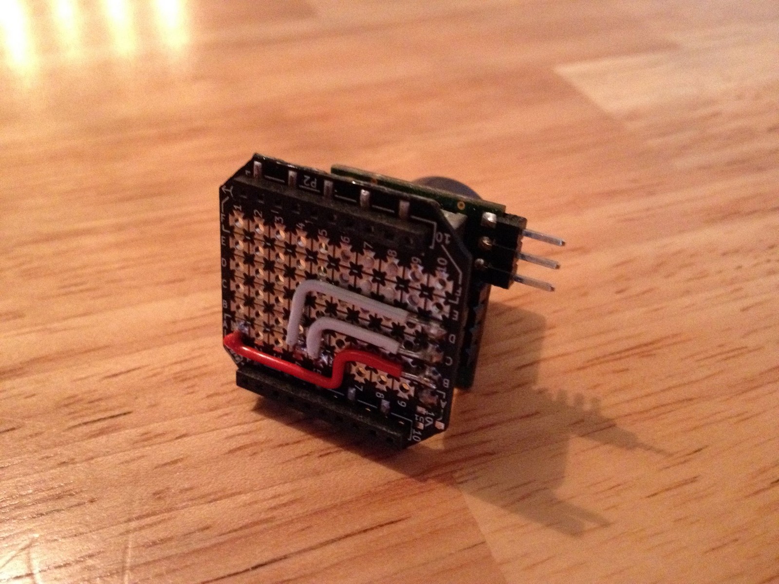

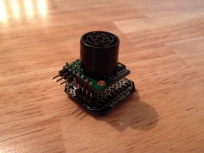

Besides the programming for reading the sonar sensor I prepared it to fit on the CF 2.0 using the Prototype Expansion Board. This is where the sensor's disadvantageous shape comes up again... Sorry for the bad lighting.

dbrgn wrote:Haha, that makes for a difficult landing :)
I got my voltage converter (I actually got a TI REG71050). Unfortunately I underestimated the tinyness of the SOT23 SMD casing... Therefore it doesn't fit on the prototyping board.
I guess I'll have to start etching my own PCBs to work around that :)
Yes, but my CF isn't meant to land but to hover! :D
I omitted the step-up voltage regulator NCP1402 on the pics above which I initially had for the breadboard circuit connected to the CF 1.0. The expansion port of the CF 2.0 supplies 3.0 V over VCC at 100 mA. That's enough for powering the MB1242. At least I hope that this voltage is regulated and doesn't fall below 3.0 V. Can someone confirm that?
Re: [SOLVED] Selecting an ultrasonic sensor and interface
At the very end of the flight the voltage can drop below 3.0V but then you should already have landed ;)
