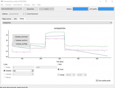

Branch gtgps-7 was created and contains the latest firmware updates. This commit contains the latest updates involving changes to function compassGyroBias() in compass.c. Gyro bias updates in imu_cf.c and thrust tilt compensation in controller_pid.c are included in this build. In order to enable gyro->yaw drift compensation using the calibrated compass, CFLAGS += -DGYRO_MAG_FUSION_ENABLE must be added to config.mk.
Perhaps another qualification regarding eeprom retention of compass calibration values is that bootloading firmware into the crazyflie that is something other than a gtgps-6 or a newer gtgps commit, will effectively erase the calibrations values. In this case, after downloading a gtgps commit, the compass will need to be calibrated once again.
I have not conducted any kind of thorough parametric analysis of the gyro->yaw performance, but here are a few of my recent observations.
The gyro->yaw appears to have a drift on the order of 5 or more degrees per minute when using the latest imu_cf2.c module from the github crazyflie-firmware-master. In the plotter tab picture, the compass.yawGyro (blue trace) is shown along with making a few manual crazyflie yaw changes. It also shows that the gyro->yaw has very little noise.
The compass (magnetometer) is a little noisy and is on the order of +/- 2.5 degrees without showing any drift. This is shown as compass.yawMag (magenta trace).
The fusion of yawGyro and yawMag is shown as compass.yawFusion (green trace). It's noise level is about +/- 1.5 degrees without drift. After a manual change in yaw, the gyro->yaw appears to lose some absolute value in the sensor fusion of gyroscope and accelerometer readings. This causes some adjustment period in the yawGyro & yawMag fusion process, but then is corrected.
This cursory examination, might lead to different conclusions, but one is that when the compass controller is available in the firmware and it has been properly calibrated, setting yawGyro equal to yawMag may provide a decent yaw measurement source for the crazyflie.
I'd be very interested in seeing comments from those much more knowledgeable about this subject.

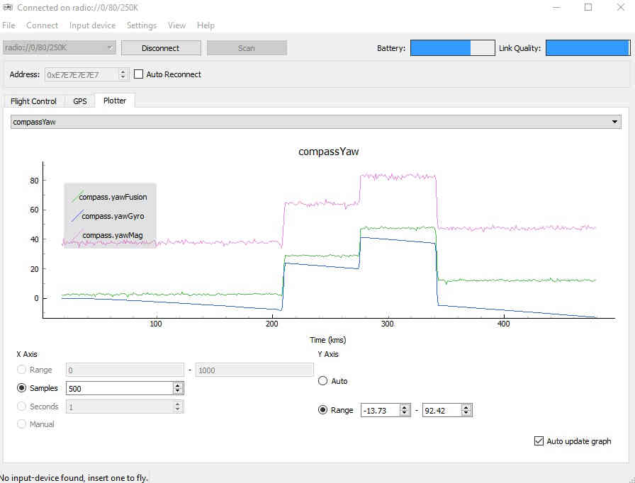

Branch gtgps-7 was revised and contains the latest firmware updates. This commit contains the latest updates involving changes
to function compassGyroBias() in compass.c. Gyro->yaw drift compensation has been disabled. The code computing drift correction in function compassGyroBias() has been simplified and appears more robust than the previous implementation. However, it appears that the couple of degrees of noise being applied to gyro->yaw is too severe and can cause yaw instability.
The corresponding plotter traces for yawGyro, yawMag and yawFusion for this update are shown below:
yawGyro is without drift correction as well as stabilizer.yaw (not shown). Further investigation is needed to see if the drift correction noise level, originating from yawMag, can be reduced to the current level of gyro->yaw.
