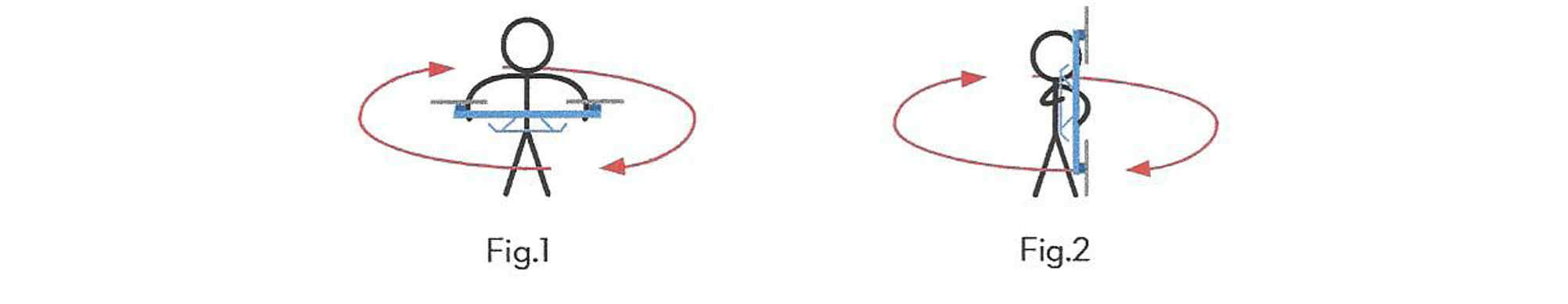

Regarding 3-axis magnetometer calibration. Recording a set of static measurements for the magnetometer by positioning the crazyflie in a large number of orientations covering a whole sphere and processing these recordings using matrix and inverse matrix computations can be quite onerous with respect to floating point math and microprocessor workload (while other real-time critical tasks are ongoing). In addition, the effective benefits for the crazyflie, that nominally is horizontal flight, appears unnecessary and unwarranted.
A seemingly more practical approach has been implemented by holding the crazyflie horizontal and rotate it around the gravitational force line for about 360 degrees. Then, holding the crazyflie vertically (for example its nose downward) and rotate it around the gravitational force line for about 360 degrees. This does not require massive data recording, and extensive floating point math computations The accuracy achieved with this simpler method should be more than sufficient for what's needed by the crazyflie. In addition, the approach implemented includes up to 90 degrees tilt (roll and/or pitch) compensation.
For those familiar with DJI Inspire, Phantom and Naza-M GPS flight controller products, this orthogonal approach is the same method they use.
Best regards,
Jack
