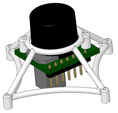

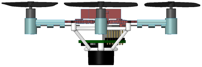

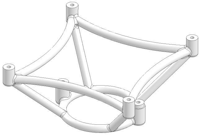

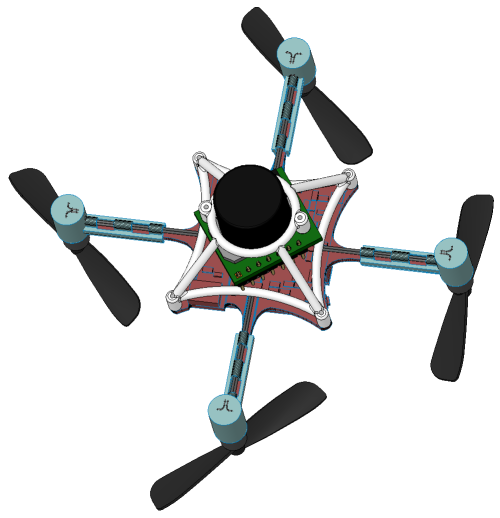

In the meantime I designed a mount for the sensor. The plan is to get a 3d print using Selective Laser Sintering from Trinckle. Made from PA, it weighs about 1.2 grams. Later on there will be a support for the step-up regulator NCP1402 providing the 3.3 V for the sensor.
