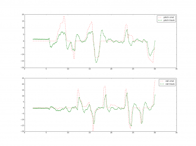

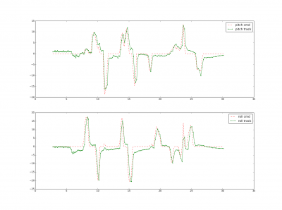

I did a simple comparison between the new and old PID parameters. The experiment set up is:
30s manual control using joystick
Optitrack motion capture system tracking the crazyflie2
ROS recording joystick command and Optitrack data
Here is the result. (yaw input is yawrate, ignored here)
1. Roll/Pitch response using old PID parameters. Average error is 2.92 degree for pitch, and 2.27 degree for roll. cmd is the joystick input, track is the Optitrack data.
2. Roll/Pitch response using new PID parameters. Average error is 1.59 degree for pitch, and 2.22 degree for roll. cmd is the joystick input, track is the Optitrack data.
That's almost a 25% accuracy improvement. We can also see the crazyflie is now tracking large roll/pitch angle inputs very accurately. Very suitable for advanced flight. Great contribution indeed!

Li, those graphs are super interesting to see. Thanks for sharing. Could you give a rough number for what the latency is? It's observable but too small to figure out what the value is from your graphs.
It's also really interesting to me that the roll error remained relatively constant between PID values as compared with pitch. I'd have expected them to be the same given the symmetrical design of the crazyflie.

From what I observed during some autonomous flights, the latency is about 0.1s with logging frequency of 50Hz.
Yes, the Crazyflie is symmetric. But the tracking markers I attached to the Crazyflie is not symmetric. The markers I placed are slightly off the center in the roll direction. The motion capture system needs non-symmetric marker placement to identify correct heading direction and distinguish between multiple crazyflies.
Li
theseankelly wrote:Li, those graphs are super interesting to see. Thanks for sharing. Could you give a rough number for what the latency is? It's observable but too small to figure out what the value is from your graphs.
