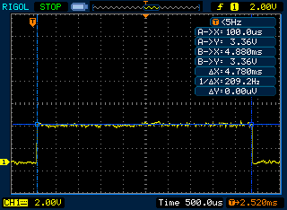

The motors spin up just normally and the red heart beat (low frequency) shows up. The latter is only visible as long as the copter is moving. As soon as I place it on the table and the self-test/IMU calibration passes, the red LED flashes one or two more times (with higher frequency) and then stays dark. At this stage I can find the copter with the PC Client, but connecting isn't possible. I was able to see a very short I2C communication (few milliseconds) on the oscilloscope when powering the copter so I'll try to trigger this again and take a screenshot. I could take a video of the copter's start-up, too.
Any suggestions?

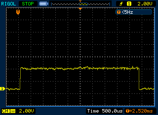

- Added function to change the I2C address of the sonar sensor. See my repo, branch "sonar-cf2"
- Successfully changed the sensor's address to 0x30.
- Verified the new address via sensor pin 2 by looking at the address announcement with an oscilloscope (pin 2 high for 4,8 ms on start-up represents 48 dec which equals 30 hex).
- Changed the I2C address (MB1242_I2C_ADDRESS) in my code to 0x30 accordingly, of course.
Unfortunately, this doesn't solve the hang-up on copter's startup:

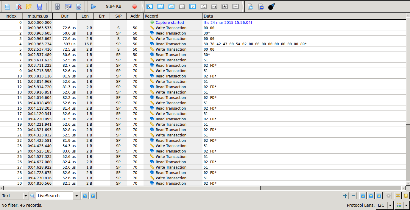

I got a MB1242 in the mail today!
I hooked it up to a breadboard and grounded pin 1 to set default address (0x70). I changed that in your code and tried it.
It started communicating right away however after ~10s it stopped and the CF2 froze. (timeout bug) because the MB1242 didn't answer for over 100ms.
I changed the code to only take readings every 100ms. it still froze after a while. Now I changed the I2C clock to 400kHz and now it seems to be communicating fine. One little problem though, the range reading is always 765 (0x02FD)... Have not yet investigated this.
You haven't by any chance wired the MB1242 wrongly, swapped SDA and SCL?

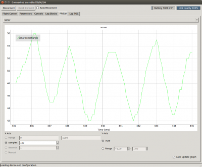

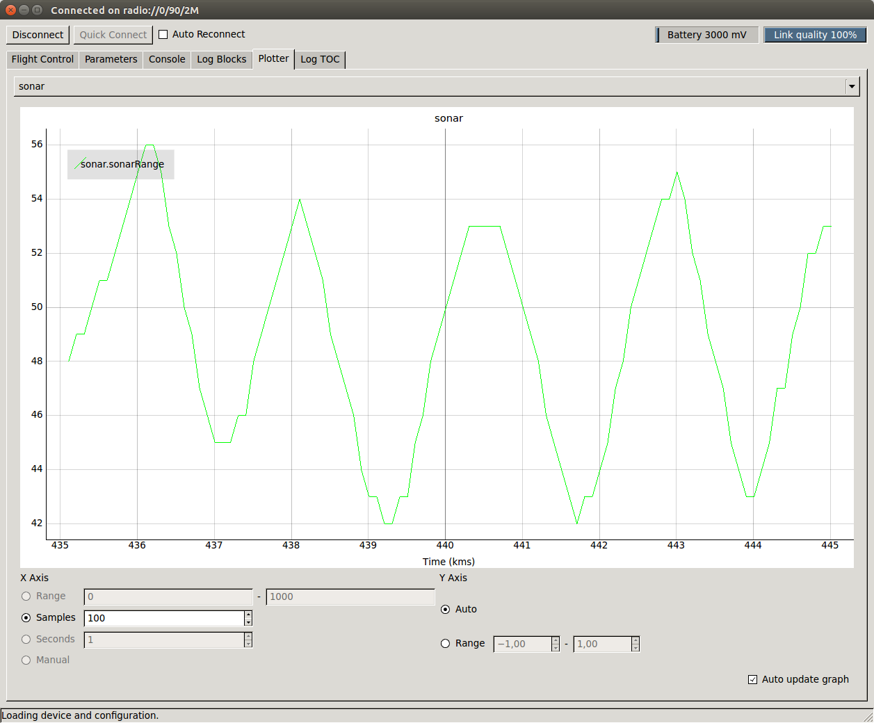

Apparently my fat belly was not a good object for the sonar to take readings on and now it seem to work pretty fine. I also soldered the header on the MB1242 which I didn't want to do at first which could have made a difference.

What's that software on your screenshot for I2C debugging called? Is there additional hardware needed for this?
I'm going to play around with my equipment again tonight, check my prototype soldering and breakout board wiring.

Yes it requires additional hardware and I'm using the beagle from totalphase. There are many alternatives e.g. the bus pirate.What's that software on your screenshot for I2C debugging called? Is there additional hardware needed for this?
My best guess is that the MB1242 doesn't respond for some reason. As talking to the EEPROM works? the I2C bus should be functioning. An analyzer would help you find the problem quickly.
