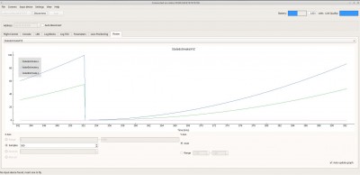

Here is the result of the stateEstimate.x/y/z that I get when the drone is stationary at the centre of the play area. Not too sure how to interpret the graph though.

Thanks for sharing! This is making a lot of things clear. what you see is the values diverting, which means it is not getting enough information to estimate position. You have to step back to when you were still setting up the lighthouse positioning system because this has failed somewhere. Probably when you tried out the single crazyflie scripts, it worked for you because of the flowdeck, but not because of the lighthouse deck.
Go carefully through the guide again until you see those values on the plotter of the state estimate become stable. Also check the console tab of the cfclient if the deck is detected at all.

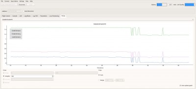

I have read through the guide again already. Here is the data that I got from the plotter:
Everything seems constant, but when I run the code, the drone still doesn't seem to work still. An 'Error no LogEntry' problem also came out while executing the script.

that plot looks much better.
With the drone not working, do you mean that they still crash or just don't take off at all? Have you tried again the commander scripts for just one crazyflie?
