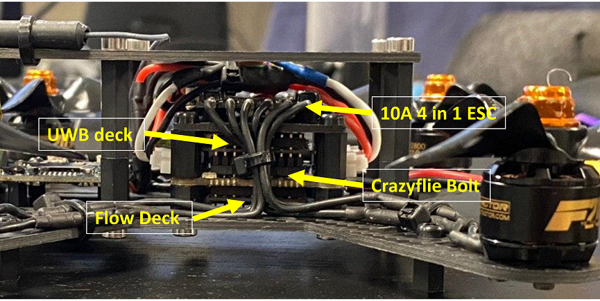

Hi, my apologies but I would need to check this out next week. Currently I don't have access to the LPS system since I'm working from home. But bear in mind that I will only be able to test this out on a crazyflie since I don't have the same quad setup as you, so it might be hard to figure out exactly what is going on.
Do you have a picture of your quad, with a close up how the placement of the lps deck is done? Also make it face the positive x directly, (this can be checked by the lps tab or the stateestimate.x/y/z log plotter.
