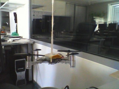

In my case th M4 is equal as the others! Trying to uderstand what is the thrust value for the hovering i keep the cf suspended with a thread and then i increas the thrust step by step until it stats to hover. During this easy test the cf drifts a lot of. I tried to correct using a trim on the roll and pitch but it doesen't work!

The ground effect when flying close to the ground can sometimes do strange thing. What if you "shoot" the Crazyflie in the air by applying a lot of trust. Does it go strait up or drift to a side?

I avoided the ground effects keeping the cf suspended on the air with a thread:
