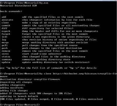

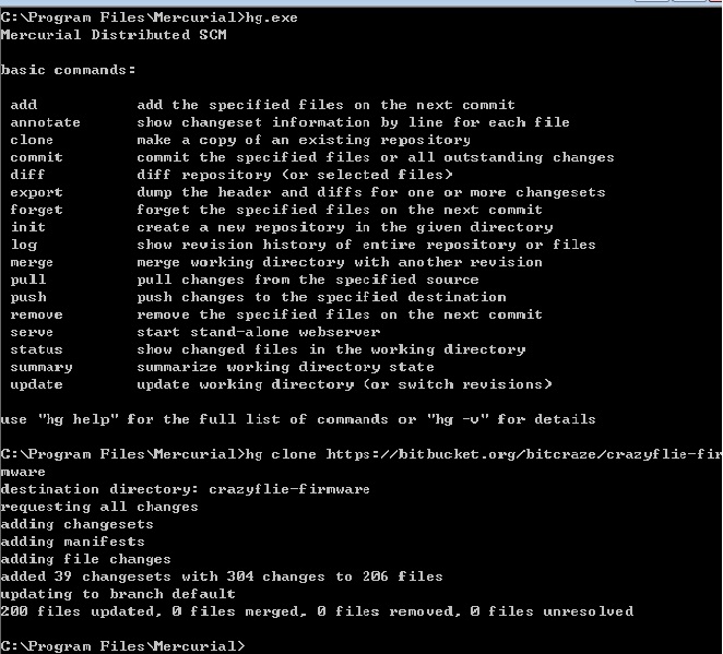

My hg The installation path is C: \ \ Program files \ mercuiral \...
The diagram below

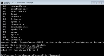

Good news,,, I think I have already download success! But I still can't complete the firmware compile. Tips!
smokedasphalt
Posts: 16
Joined: Sun May 19, 2013 1:51 pm
Location: Pune, India
Re: How to Compiling CF's FW on win7 !
Post by smokedasphalt »
Have you installed python2.7? Can you run the command python in your command prompt? If you can't, then please install python2.7 from here http://python.org/download/ and follow the instructions to set up the pythonpath from here http://www.anthonydebarros.com/2011/10/ ... windows-7/
