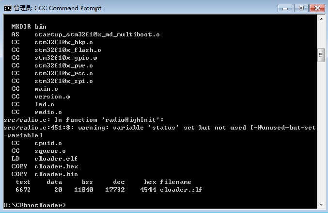

good news! i try to compiling CF BOOTLOAD FILES ,,,,,,it's okay !
so .why i used make command to compiling CF Firmware ...display error informations.

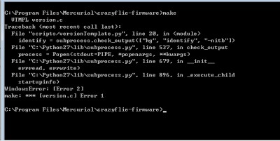

@smokedasphalt - Thanks for the tip! I thought I had that installed, but I recently uninstalled a bunch of stuff. It got a lot further, but now I'm getting the version.c error others have mentioned.

VTMPL version.c
File "scripts/versionTemplate.py", line 20, in <module>
identify = subprocess.check_output(["hg", "identify", "-nitb"])
File "C:\Python27\lib\subprocess.py", line 537, in check_output
process = Popen(stdout=PIPE, *popenargs, **kwargs)
File "C:\Python27\lib\subprocess.py", line 679, in __init__
errread, errwrite)
File "C:\Python27\lib\subprocess.py", line 896, in _execute_child
startupinfo)
WindowsError: [Error 2] The system cannot find the file specified
make: *** [version.c] Error 1
C:\CF\bitcraze-crazyflie-firmware-e6f9fbdc42b3>-

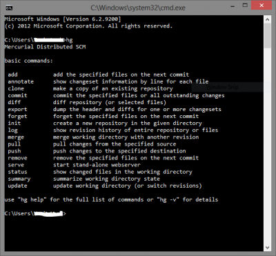

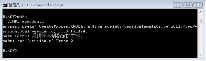

@JoshLillie - Have you installed Mercurial for windows? Is it in your PATH? (Type hg in the command prompt and you should see some output instead of an error.) Once that is done, clone whichever repository you want by running hg clone URL after replacing URL with the link to the repository. (for example, if you want to clone the firmware by Bitcraze, the command looks like hg clone https://bitbucket.org/bitcraze/crazyflie-firmware)

Have you installed Mercurial? Make sure it is in your PATH. Then clone the firmware repository using hg clone URL. (Refer to my reply to JoshLillie in my previous comment.) Once you have the repository, cd into it and then run make CLOAD=1gl516 wrote:GCC installed in the Windows 7 ARM Emb and python 2.7
The entire process looks like this
C:\Users\Test\Desktop>hg clone https://bitbucket.org/bitcraze/crazyflie-firmware
C:\Users\Test\Desktop>cd crazyflie-firmware
C:\Users\Test\Desktop\crazyflie-firmware>make CLOAD=1
Build 38:e6f9fbdc42b3 (tip) CLEAN
CrazyLoader build!
text data bss dec hex filename
48060 400 19344 67804 108dc cflie.elf
rm version.cRe: How to Compiling CF's FW on win7 !
