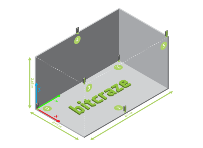

My coordinate system is right-handed, it's just rotated 90deg relative to the one you provided - in swarmSequence.py, you have a diagram of the nodes and starting positions at the start of the code, these don't match my orientation.
I have altered them to match my lab setup and this did initially yield a perfect result, I just couldn't replicate it! I'll try rotate the CF's themselves and update.
