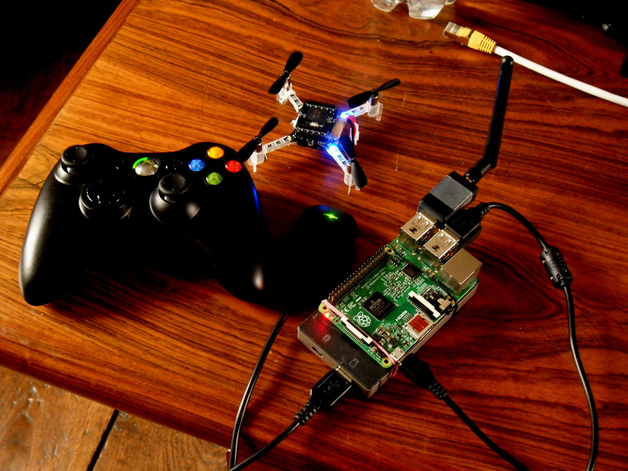

Wireless xbox360 is a strange guy ! After failure on every system of mine, it worked on raspbian (you can see my light control system).
And, 0 surprise, this morning, it works also on my Lifebook/debian....
