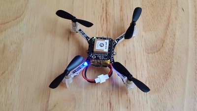

I have the Crazyflie 2.0 running gps using the Titan-2 module. Firmware is in an advanced development stage (feasibility patchwork), but eventually hope to get a working position hold capability. Effort so far has been running the gps indoors without SBAS/WAAS corrections, and will soon be testing it outdoors with better visibility to the Galaxy 15, Telesat Anik F1R or Inmarsat 4F3 satellites that provide corrections over the western U.S. and hopefully begin to see 3D/DGPS position fixes. Later the Crazyflie 2.0 with Titan_2 was tested outdoors, it auto synchronized with the Galaxy 15 satellite to obtain WAAS corrections and successfully produced a 3D/DGPS fix.

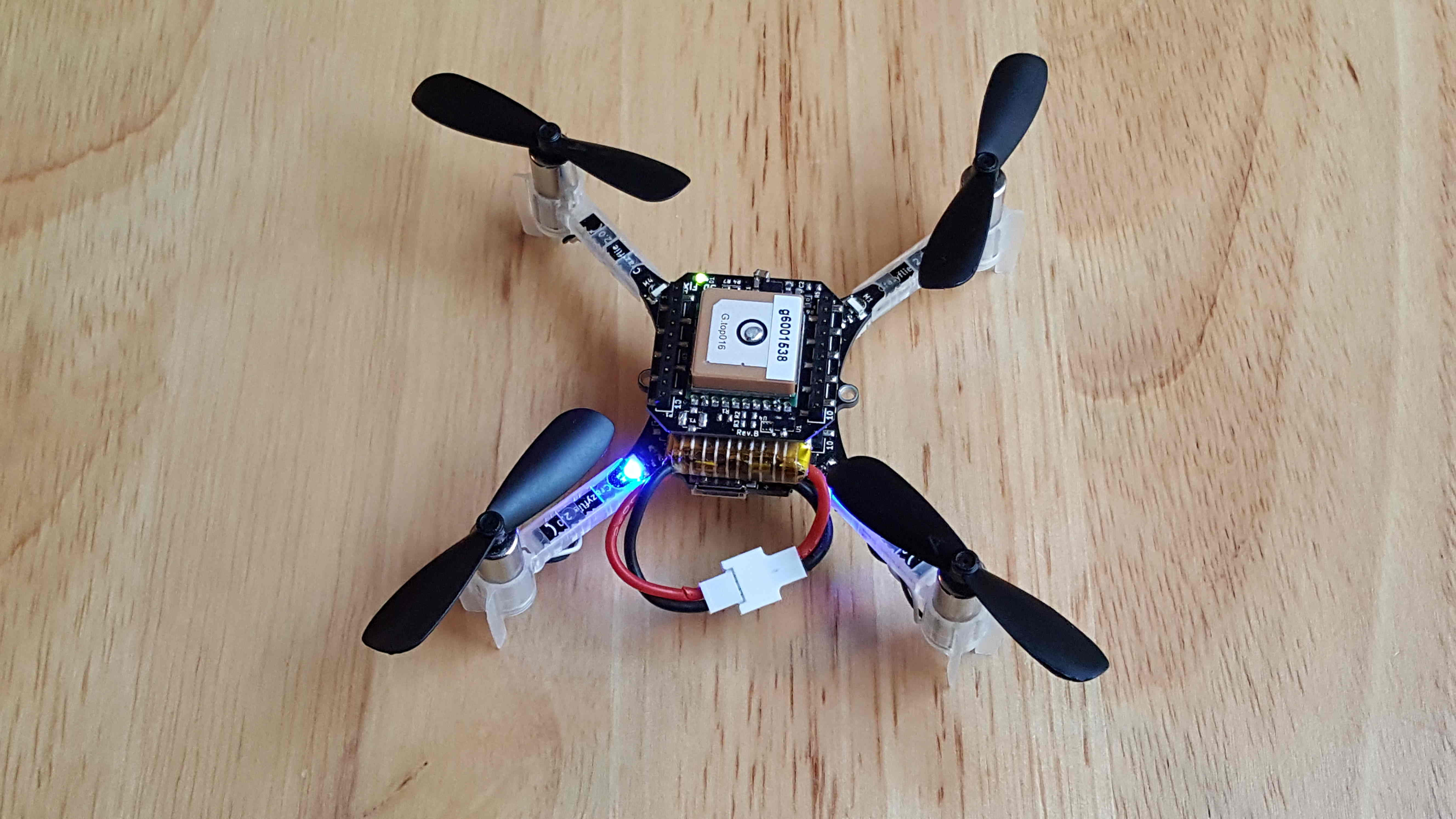

It's on the backside front edge if I recall correctly (only feasible place I could find).On the prototype deck, I missed seeing an inductor component

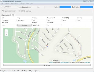

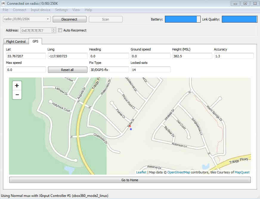

(1) My prototype GT GPS deck driver now includes Binary Mode processing of position fix data and data appears on the GpsTab in PC cfclient.

(3) When the Crazyflie 2.0 is turned off, the PB7 expansion pin (WKUP) cannot source enough current/voltage level when connected to the battery backup input on the GPS receiver (VBACKUP pin that preserves the GPS real time clock, last location, ephemeris and almanac data held in internal SRAM memory). This was commented on in some earlier posts (June 01-03 2015 Crazyflie 2.0 with GPS). At some point I'd like to investigate tying PB7 (WKUP) and PB6 (N_I01) together to see if their input pull up resistors will supply enough current and hold the voltage to at least 2.0V and above.

Examination of the GT Gps Titan-2 module binary mode output looks like the altitude value is height above the datum (WGS-84) ellipsoid (in meters) rather than height above the geoid (mean sea level). I believe we require hMSL and I have asked GlobalTop to look into this.
