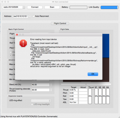

i have it up and running I'm flying the drone however now i don't see any feed back on the display also i am unable to control input commands make it hover and such the drone needs adjustments in pitch and yaw but I'm unable to correct any suggestions

My friend,mrzahmed6 wrote:i don't see any feed back on the display also i am unable to control input commands make it hover and such the drone needs adjustments in pitch and yaw but I'm unable to correct any suggestions
It is especially aggravating when I'm spending time helping you and you disregard what I've already written. I explained exactly what you need to do to get the client working correctly in my previous post!
You are using the wrong python version and wrong client release. If you had read what I wrote, you would have seen that you need to install Python 3 and dependencies and use client version 2015.09. All of this is detailed in the blog post I linked you to.
If you don't want to read and try what I've already taken the time to write for you, I'm not inclined to help you any longer.

hi I've followed those steps to a T and i mean exactly how they were laid out i have the drone operating it flies and i control it fairly well however the gui on my computer is not showing horizon and i can't program any remote controls such as hover at altitude and whatnot i have pitch and yaw adjustment working but I can't get the hover button to work every time i push the button it kills the program i am using the version of python u recommended. i apologize for irritating you it was never my intention i only asked for help and you don't have to be so upset about it. though i am sorry i don't mean to make it aggrevating.
