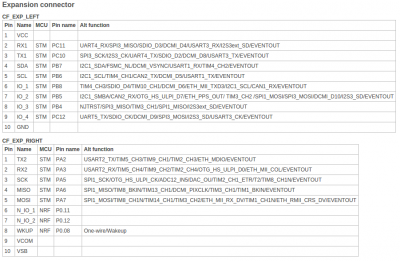

Is there any documentation about what I2C port to use for connecting peripheral devices? The documentation is still lacking these simple but important facts.

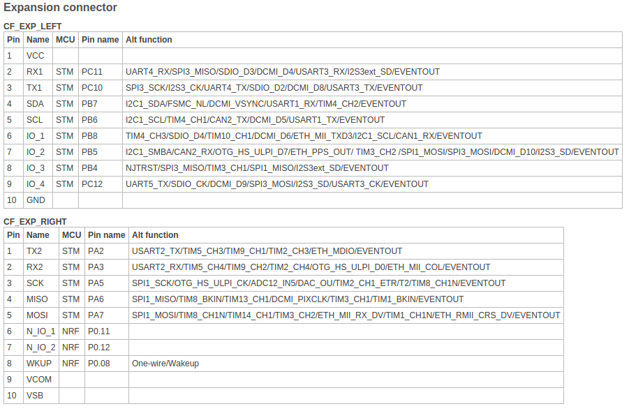

Not yet really but it is on its way :oops:. So for the moment one have to look at the pinout, schematics and the STM32F405 documentation. I uploaded a image of the mapping until we have made it more clear.
The expansion port i2c is on I2C1 (same as eeprom).
Expansion port pins
Expansion port pins

Re: CF 2.0 not restarting in firmware mode after flashing
OK, I did some SWD debugging and I found a bug. The ST I2C library (CPAL) get stuck in a timeout. This happens when there isn't anything to communicate but works if things run as it should. So I'm thinking you aren't getting any answer from the sonar sensor? I tested just changing the MB1242 driver to talk to the eeprom instead (setting address 0x50) and then the code runs. Are you able to check that the MB1242 sensor answers, with an oscilloscope or similar?

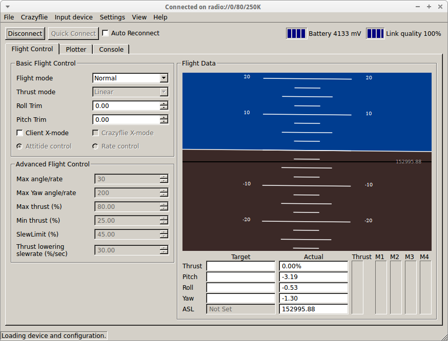

I set the I2C1 bus (for EEPROM and sonar) to 100 kHz and the copter starts up normally. The LEDs are acting as the are supposed to and I get a stable connection. Pushed the changes to my repo.
But: The telemetry data in the PC Client is still showing weird values (e.g. the ASL). Neither the data fields nor the artifial horizon react to the copter's movement in my hands:
This is the console output:
SYS: Crazyflie is up and running!
SYS: Build 19+:5c0dfad6956c (2014.12.0) MODIFIED
SYS: I am 0x37333632313347032B0040 and I have 1024KB of flash!
IMU: MPU9250 I2C connection [OK].
IMU: AK8963 I2C connection [OK].
IMU: LPS25H I2C connection [OK].
MB1242 I2C connection [OK].
EXPBRD: Found 0 memories.
EEPROM: I2C connection [OK].
AK8963: Self test [OK].
LPS25H: Self test [OK].
OW: Found 0.
SYS: Free heap: 6048 bytes
30 78 42 43 0 50 0 0 0 0 0 0 0 0 0 7D
Status 0
Well to steps forward and one back :).
I'm thinking there is still something wrong with the i2c buss then. If you flash the release software I guess everything is working as it should (to rule out cfclient issue)?
