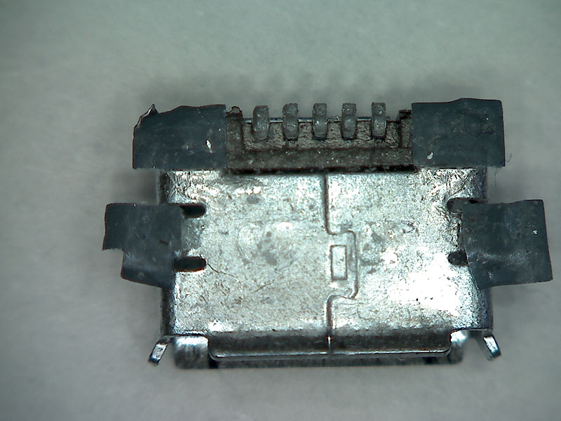

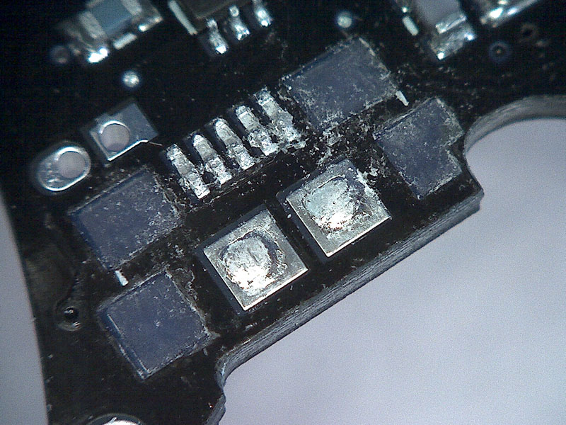

Thanks for the quick reply. Attached are photos of the torn-off USB jack (pads facing up) and the mounting location on the CF board. It definitely looks to me like the solder pads have torn off with the jack; the color is off, but in case the board photo isn't clear, the four surfaces where the jack should attach to the board are a dull non-metallic brown, while the other surfaces are shiny metallic silver. Do you still think some kind of glue might reattach the jack strongly enough?

It looks like the physical mounting pads have indeed been pulled off the board. However, the actual USB connections look like they may have been cold solder joints in the first place. They look okay. Maybe some extra solder but the pads are still there.
How good are you with a soldering iron? Have you done SMD soldering before? You might be able to just reattach the usb jack using those 5 tiny pins... And then use a bunch of hot glue as the actual physical connection.
Be careful with those pads though... and maybe you can solder everything up with a usb cable in the jack itself so you can do a quick connectivity test before you put hot glue on the thing...

Jamisnemo: Interesting idea. I had assumed, since the five tiny traces on the board looked so shiny and undisturbed, that there never was any solder on them and that the pins on the jack were just being held against them by pressure from the mechanical connection. Can you state authoritatively that the pins are normally soldered to those traces in these Micro-B situations?

Those pads definitely had cold solder joints. Which is probably why the pads didn't get ripped of along with the USB connector (like the mechanical pads did). This type of connector is definitely meant to be soldered on.
Re: HELP: USB jack torn off
Those pads are not electrically connected so you can use them without any problem.
