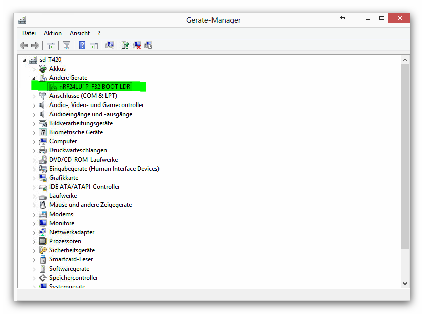

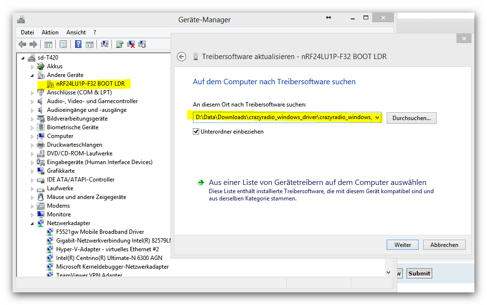

I have problems with installing the driver on Windows 8 64bit. I set Windows 8 in test mode (enables unsigned driver install) an tried to install the driver how it is described in the wiki. I use the latest river from bitbucket.
But every time when i choose the folder where the driver files in windows says there is no driver for the device in this location, see the screenshots:
Manually selected driver (destination of crazyradio drivers):
"Browse for driver software on your computer"
After selecting an clicking "next":

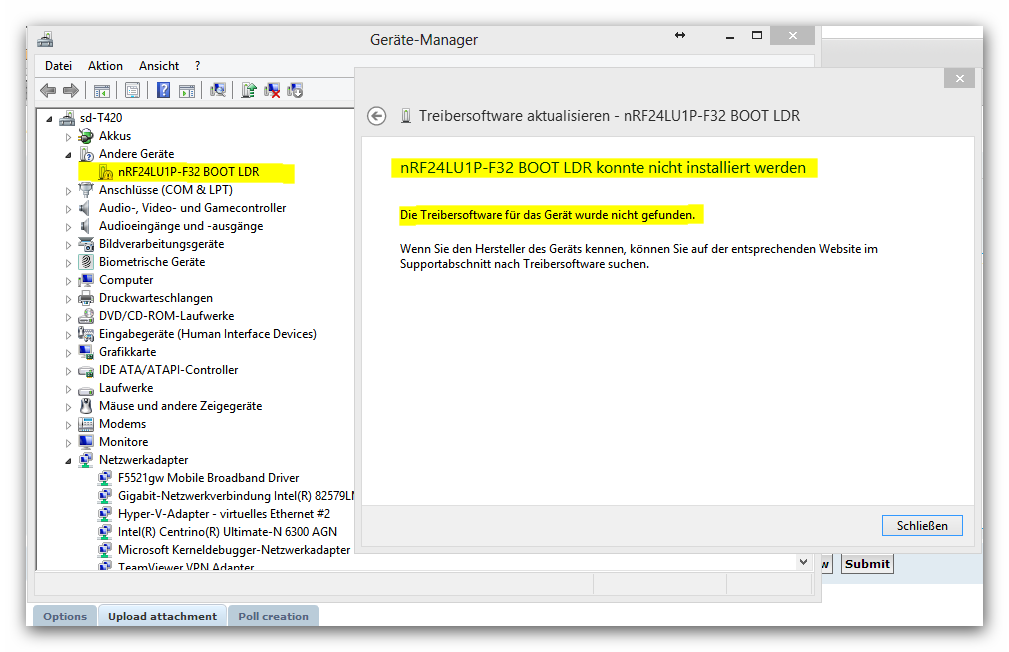

"nRF24LU1P-F32 BOOT LDR can't be installed"
Last screenshot says "the driver couldn't be installed - driver software for the device wasn't found".
Do anyone have the same issue or knew how to fix this problem?

I reconnected the CR to windows and tried to install the driver know, result is exactly the same as before, if i install the drive by choosing it manually from the download location windows responds "the driver couldn't be installed - driver software for the device wasn't found". Here's a screenshot:
Do you have any other ideas what i can check or have i done a mistake?

The description in device manager is still wrong. It should say "Crazyradio USB Dongle" if the CR firmware was running.
What description for the CR does virtual box show?
