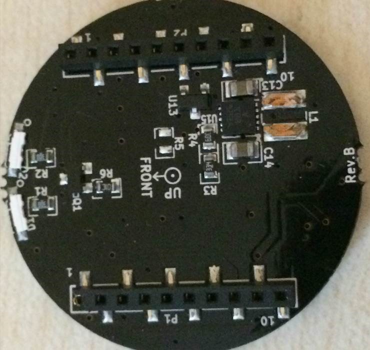

Here is the LED-Ring electronics picrure:
The LED-Ring electronics

The component (power inductor?) at L1 looks different from mine. Did it get broken off?
Component L1
Component L1

It seems as if L1 has broken off and this is definitely this cause of your problems. It should look like the image chad posted. Was it delivered like that? Could you check the bag to see if it's in there?
