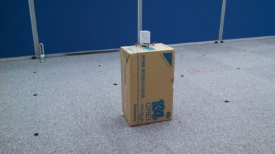

About the detection size: for my case I start using the Kinect to control the flie since taking off. To make it detectable, I have to put a box on the floor as the take-off stand, so that the difference from the background is large enough. Also in my case, the detected size is smaller when the flie is on the box, as the part closer to the box has too small difference to be detected. Setting wider range of detection size already solved this problem (or at least seems so.) (I also found a little problem with part of my lab's wall, that it somehow reflects the IR light weirdly, causing too much noise which are around the same size as the flie, so they got detected. Anyway, I solved this by using partitions to block those materials and everything comes to a peaceful state)
