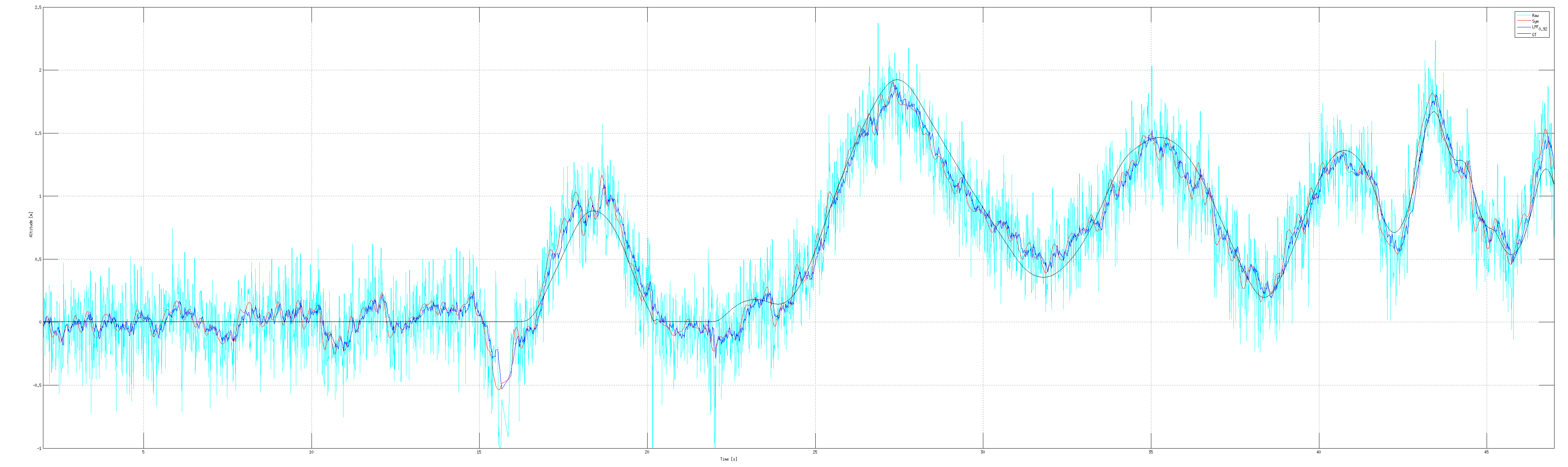

I read temp once, then pressure 9x. And that at 100hz!
Oh, and you probably want to smooth the signal. I found pressure = pressure * 0.92 + new_pressure * 0.08 worked best.
Some example measurements with the LPF and raw signal: http://goo.gl/N9GUc
Good luck, let me know if this helps.

I have logged the alt reading and tested with out motors running. I think filtering is required even with motors off. I wondered about the "blowing about" causing issues when the motors were running, and also motor related spikes on the supply. I'll try some foam or something. I have just added SW filters to the alt and at the moment the readings look alot better but the control gains now need a complete reconfiguring. Its currently not hovering at all at the moment.tobias wrote:I read somewhere that it is good to cover the pressure sensor with some breathing foam or similar to avoid the effect from the airflow from the propellers. Something worth a try to get better reading.
I think one of the threads noted that there was a drop of about 50cm on takeoff. Ie the logs indicated it drop 50cm below the takoff height, which did not really happen it did not drop through the floor. Perhaps foam would help remove this. I've not been able to log stuff this effectivly yet.

I guess the reference you are looking for is this one: Graph of real height vs barometer estimate - https://lh5.googleusercontent.com/-AFuo ... export.png
At t=15s the motors spin up and at t=17 seconds you can see the flie achieve lift off. The corresponding barometer estimate clear drops to -0.5m.
