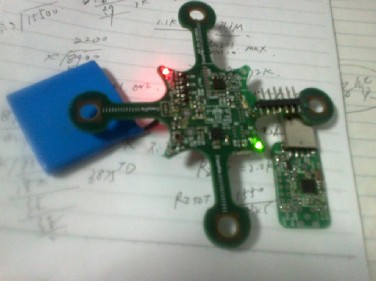

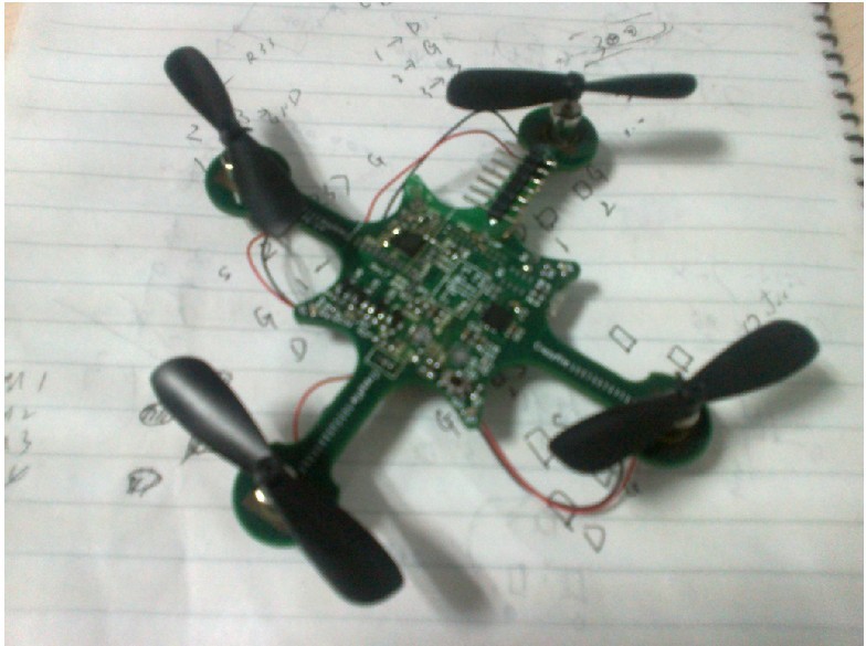

I have make the crazyflie and crazyradio myself.
it seem's the crazyflie can work,as the red-led can blink 1Hz or 2Hz, also the PC can find the carzyradio.
but when I use the PC-client, I can't scan any crazyflie.
So I guess there maybe some bugs in the RF, and is there some advice to help me step by step to find the bug in the crazyradio's RF or crazyflie's RF
It's my crazyflie and crazyradio

That's a nice design! It would be interesting to know a bit about the design, what program did you do it in? Is it a 4 layer board?
The green LED is supposed to blink when messages are being sent on the radio link and the red is supposed to be a heart beat (i.e blink when the system is working). So if they both stop it's definitely a crash. Did you change the firmware at all? I would recommend you to get a JTAG dongle to be able to do some debugging.

yes, it is a 4 layer board, and is designed by Altium designer 10.
and i changed some thing, such as not use the battery charge circuit, and use a lock switch.
btw, before i connect the crazyflie,i did not configure the analog input device,does these have effect?
the crazyflie and crazyradio's image are build form the VM0.2 with no update.

I have finaly connect to the radio and now it can fly ,all I did was using the VM0.3, without any hardware changed.
but there is a problem, when I fly only use the thrust,the CF can takeoff,and always move to a fixed direction.
why this happen, maybe the motor differents,or some other reasons? Thanks.
marcus
Posts: 659
Re: howto fix the RF bug
Post by marcus »
No, the firmware will compensate for differences in the motors. It might be the accelerometer that is not mounted flat.
