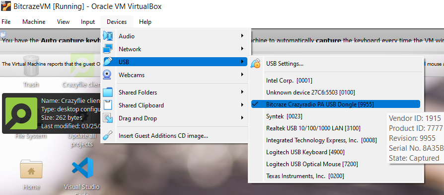

The error says that it can not find the crazyradio, which is quite clear fault. Have you selected the crazyradio usb device in your virtual machine, like this? It's device>USB>Bitcraze Crazyradio PA USB dongle (there should be a check there)

Adding to that, I was referring to the cfclient console. If you don't get any output when connecting with radio you can try with USB. If you are using the VM don't forget to hand over the Crazyflie USB device to the VM.
