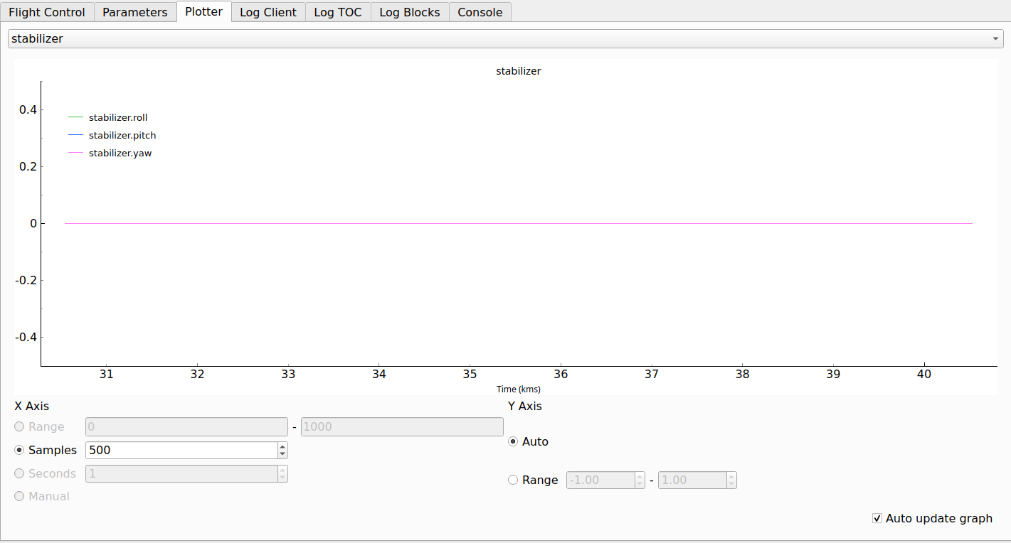

I would try to change the threshold, but the raw gyro measurements are nonexistent. This problem doesn't seem to be an inability to calibrate, it's an inability for the drone to get IMU readings at all.
As you can see, the stabilization values are flat-lined, not reading any sort of disturbance.

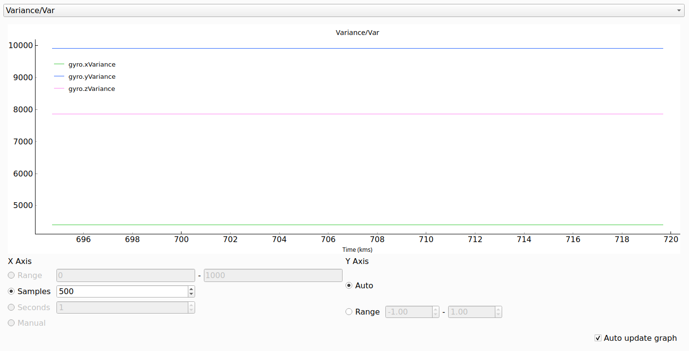

The stabilizer values are zero because the gyro has not taken its bias. Can you log the gyro.xVariance, y and z instead?

Ahhh, I see now. Here is a picture of the variances before changing the threshold.
After changing the threshold and rebuilding the firmware, the drone finally started reading values for stabilization. Thank you for the help, I apologize for doubting you!

If you have time I would very much like to see the variance values when it does not manage to calibrate. In your graph they are fixed because the crazyflie managed to calibrate. Also they are below 10000, which is the default, so maybe you did not have a stable enough surface before?
