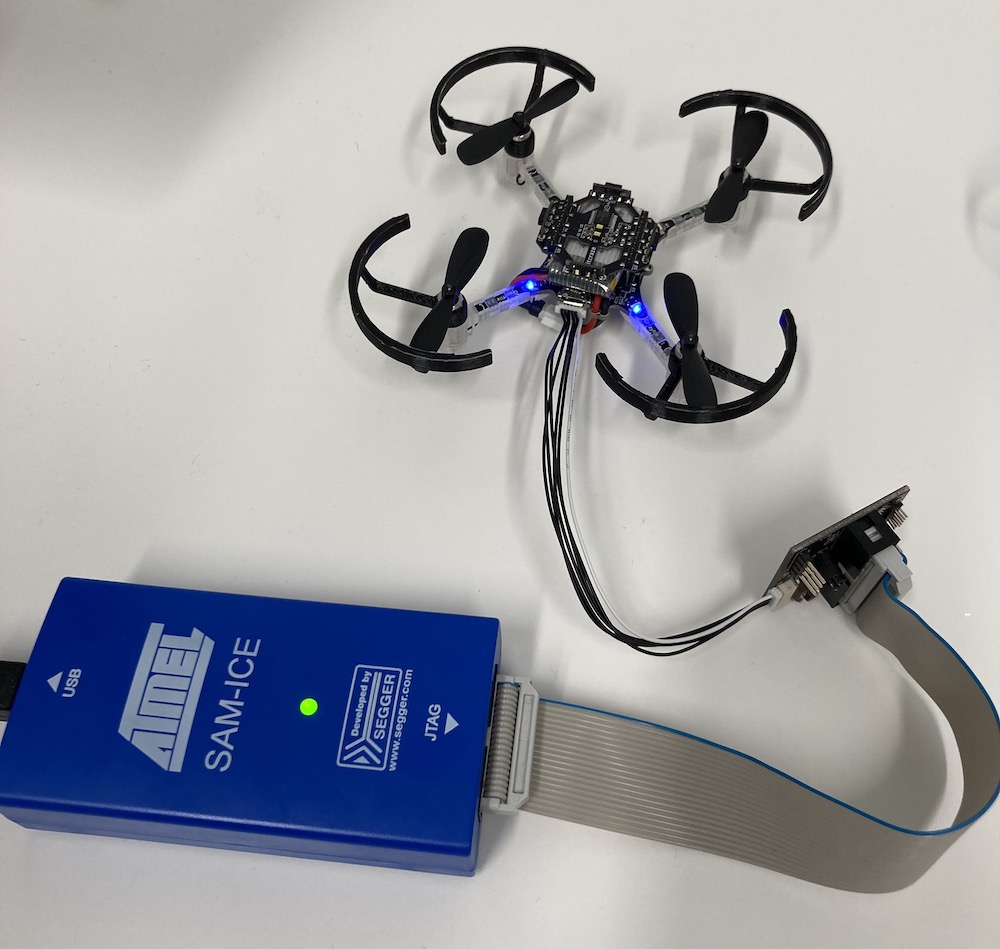

I've been trying to make a JTAG debugger work with Crazyflie 2.1, so far without success.
The device is called "Atmel SAM-ICE", its interface is SEGGER J-Link, I followed instructions on this page:
https://wiki.bitcraze.io/doc:crazyflie:dev:starting
I was able to flash the firmware, however, as for debugging in VSCode, I get this error:
