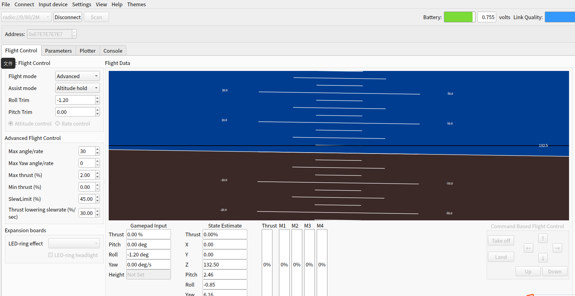

By the way,I noticed that when I used bigquad and crazyflie2.1,and connected them with the cfclient,
they cannot automatically calibrate the attitude angle,the longest white line will not gradually and automatically level up like only using crazyflie2.1,and it will stay tilted unless I move the control panel.
Is this normal?
When installing the crazyflie flight control board, the flight control board will not be absolutely horizontal and will inevitably have a certain tilt angle. Will this affect the flight of the drone?

It could be hard to mount the bigquad+cf2.1 perfectly level. A couple of degrees from zero will not cause any problems but it is possible to calibrate this away. In the firmware configuration dialog in the cfclient it is possible to enter Pitch and Roll trim values. Just enter the values the flight tab is reporting when it is sitting level. A restart is required for it to take effect.
