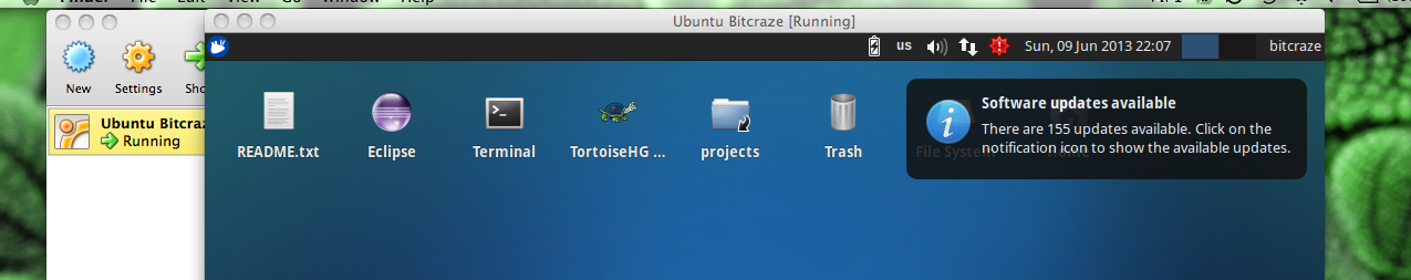

I got stuck on 6. I typed that into the terminal and it from what it looked like it didn't give me errors. I moved onto 7 but I got stuck so I closed everything down and when I opened everything back up again the program shows that it has a lot of updates. What does this mean? does this mean that the terminal command did not work?
I tried to move onto 7. and typed in the command and I was able to see horizon etc but it was non responsive to my crazyflie. I then shut everything down to take a break and when I came back to everything I was unable to find a way to open this window with the horizon again. I even tried typing in python bin/cfclient into the terminal but this time it just gave me an error message.
Wow I had no idea what I was getting into. This CF seems to be best left for the professional programmers =( Can anyone help a laymen here?

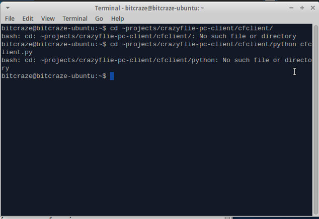

can't get the terminal to work either. I followed the instructions and typed in terminal exactly what was told in the readme.text and this is what it keeps doing.

dwaddsy wrote:can't get the terminal to work either. I followed the instructions and typed in terminal exactly what was told in the readme.text and this is what it keeps doing.
Two problems here:
1) You don't have the client checked out into the directory that you are trying to use.
2) The second command is weird. You probably meant
python cfclient.py
Although it wont work because you're not in the right directory.

First of all, about the updates. The updates in the picture you posted are for the actual Linux OS you're running - the 'hg pull && hg update' command just updates the Crazyflie client, not the actual operating system. You can install the operating system updates if you like, but it's not necessary to get the Crazyflie running.
To clarify what smiler wrote, there are two commands you need in the virtual machine's terminal. I didn't explain what they were used for properly I'm afraid - hopefully the following makes a bit more sense.
cd projects/crazyflie-pc-client
This command changes directory to the folder that contains the client.
python bin/cfclient
This command tells python to run the program 'cfclient' that's located in the 'bin' directory.
We could actually combine these by running:
python projects/crazyflie-pc-client/bin/cfclient
This tells python exactly where the cfclient file is and so it'll run straight away.

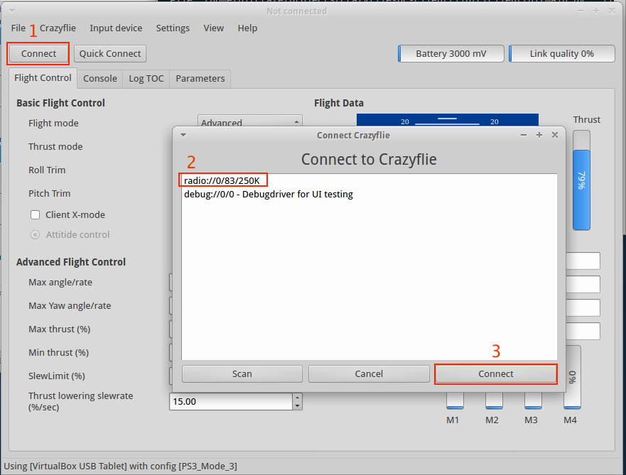

Hopefully using these commands will get you back launching the cfclient again, which brings us to the next point. Once you've managed to launch the client, you need to click the 'connect' button in the top left. This will access the Crazyradio and should, if the Crazyflie is switched on, give you at least one entry starting with 'radio://'. Connect to that and you should be able to see the horizon move!

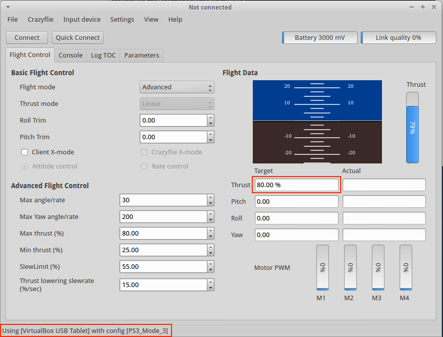

A quick note: please check the thrust setting before connecting to the Crazyflie. If your controller hasn't been connected properly, the desired thrust value can be set to 80% when you connect, which will cause your flie to rocket upwards without you meaning it to! It's happened to me before - the photo below shows what I mean.

zak wrote:you need to click the 'connect' button in the top right
--> top left
zak
Posts: 24
Joined: Thu Jun 06, 2013 6:53 am
Re: How To Fly CF with Android & Macbook?
Post by zak »
foosel wrote:--> top left
Whoops! Fixed, thanks foosel!
